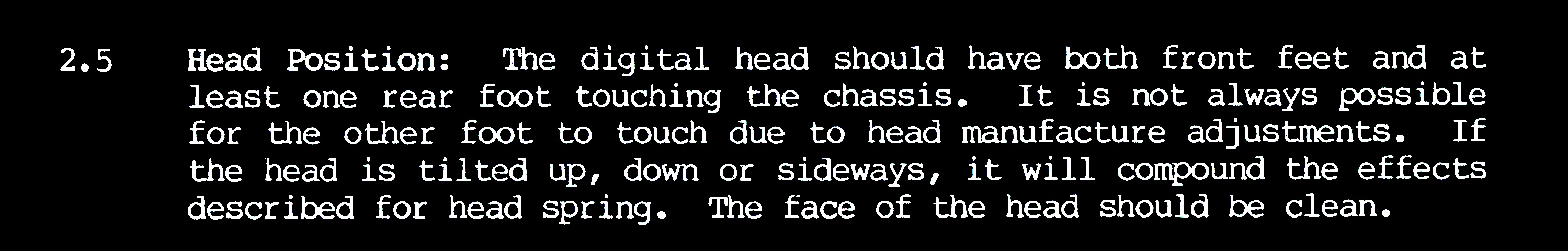

Re: Microdrive Motor Adjustment
Hi Tcat,
The QL service manual mentions the head position (see attached). I've followed the recommendation with good results. I wouldn't normally have changed the head position given its importance but needed to during the repair of several units I received as 'untested'. I've managed to swap head assemblies between units, and head boards, and reseated them all successfully.
Positioning the front two feet so that they meet the chassis makes sense as this is the reference plane. Along with ensuring that at least one of the rear feet touch as well doesn't give much room for misalignment. It would be interesting to hear if anyone has drives that don't follow this configuration (especially the position of the front two feet) and still provide good performance.
The reason for not all feet touching in some cases I assume is due to tolerances in the plastic molding. The azimuth is set by the screw on the right side of the assembly (and secured with loctite) and was most likely calibrated as part of the head manufacturing process meaning that later assembly was relatively straight forward without special tools.
Charles

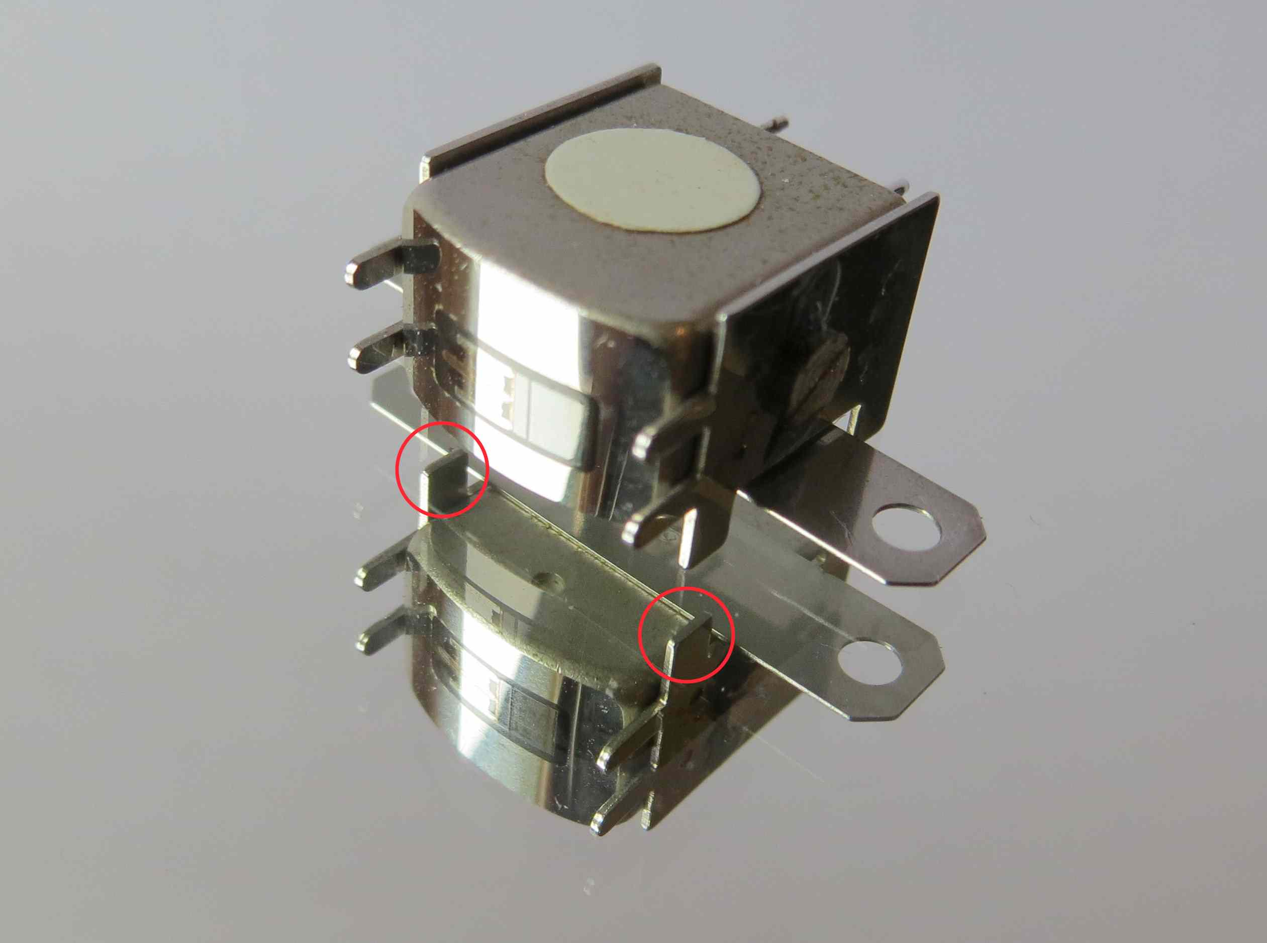

Hi Tomas,
Youre correct about the head - two channels and erase. The tape is half the width of audio cassette tape so it will be no coincidence that the head dimensions are the same as a stereo head. The head itself may have different electrical characteristics due to the different frequencies involved but I haven't looked into that so can only speculate.
As part of each head mount side plate there is a cutout on the lower side that creates two small 'feet' 1.9mm long (see attached photo).
Looking further into this, due to the way the azimuth is set by the right hand plate, it follows that most heads will only have three feet touching at once (two front and one rear). Once the head is seated correctly the tape guides will do the rest (being exactly the same width as the tape as far as I can tell).
Hope this helps,
Charles
Hi Charles,
Now I see the feet, the front feet in the red circles, right?
Hi Charles,
Thank you for explaining.
I have MD units, one with the head is slightly tilted up, and two front feet (red circled ones) not touching the chassis, the rear ones (close to head PCB board) do both touch though.
Some other MD units head slightly tilted down, two front feet touching.
Some other MD units head almost level, all four feet touching.
Read circled feet are REALLY meant as the FRONT ones, as when the head is up, it's face is up, so the feet right underneath might be also a bit lifted up?
Tape guides seemed 4-point welded to the head, and they do not seem aligned with the head in all cases I have seen so far.
I also do not understand the azimuth, is it a magnetic Norh-South orientation, or setting tape guiding slightly askew?
Thank you a lot for bearing with me.
Tomas
