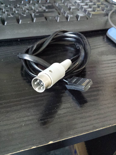

Hi folks,
Quiz time: does anyone know what this cable is for?
Mystery cable
Mystery cable
It appears to be some sort of serial lead, but that's a 4-pin DIN plug at the end, so my initial guess of a MIDI cable is wrong. I certainly don't have anything that will accept it! :D
Thanks
Matthew

ZX Spectrum +2/+3 models have a midi port that would fit into.

Which end do you mean XorA? I thought 128K Spectrums had BT style sockets not DIN plugs for MIDI? I got this lead with some other QL stuff so I am guessing it is a QL lead first and foremost.

Exactly, BT style plug in the spectrum, DIN plug in the MIDI device.

There is a software MIDI for the QL which works via serial ports, by Mark Swift. See http://www.dilwyn.me.uk/sound/MIDI_Source.zip

The Tandy Colour computer used a 4 pin DIN for it's serial port so maybe a QL to CoCo cable?
Have you tapped it out to see what pin is connected to what?

Thanks Dilwyn! The thing is, it's a 4 pin DIN plug at the end not 5 which makes me think it's not MIDI - but happy to be wrong on this.
@prime: no, I was going the lazy route first and asking on here before checking out the connections! Gosh I remember the CoCo - pretty rare in the UK as I recall - but that was a real long time ago. I think it could multi-task too back before pretty much anything else could (bar the QL, of course!) :lol:

Ooops I completely missed the bit about it being 4-pin din.

Hmm, the plot thickens... I've done the non-lazy thing and traced the connections as follows. All are zero resistance (which rules out the QL/MIDI thing based on the severe warning in the file Dilwyn linked).
If I number the DIN plug contacts looking at it so the pins are facing me as follows:
o o
o | | o
1 2 3 4
then these connect up on the QL side as:
DIN QL
1 TxD
2 Gnd
3 CTS
4 N/c
(Barrel not connected either)
I really don't get this though! Why have connections on TxD and CTS but not RxD?? :?
