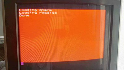

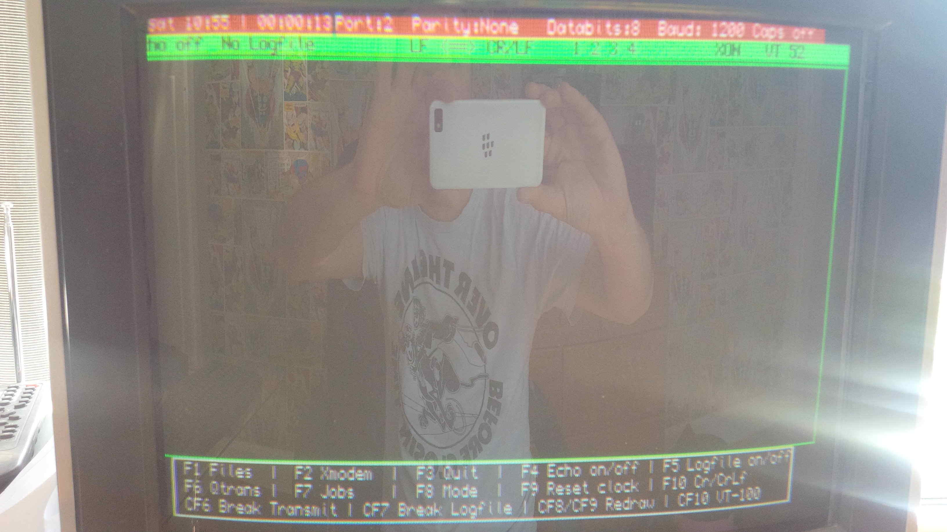

Re: QL display issues
here are a couple of pics to show you what I mean.
also tried typing in the previous post yes with print "hello world" I see all the text but typing in the window ones I see no difference on the screen.
many thanks
mark
Your QL is working correctly.
The point is that the TV is only able to show a portion of the full QL screen - a lot of games software was written to ONLY use that part which can be seen on the TV mode.
However, a lot of editors and other utilities use the full 512x256 pixel screen which is why in your first photo, you lose the top and left of the screen. There is no way around this other than using an RGB monitor, or using a modern TV with an RGB upscaler (as posted earlier on in the thread).
Try the full QL screen layout:
and compare that with the visible area on a TV screen:
You will note that the second command which will fit fully on a TV screen using a left and right offset of 32 pixels (32 + 448 + 32 = 512) and a top offset of 16 pixels (16+240 = 256)
