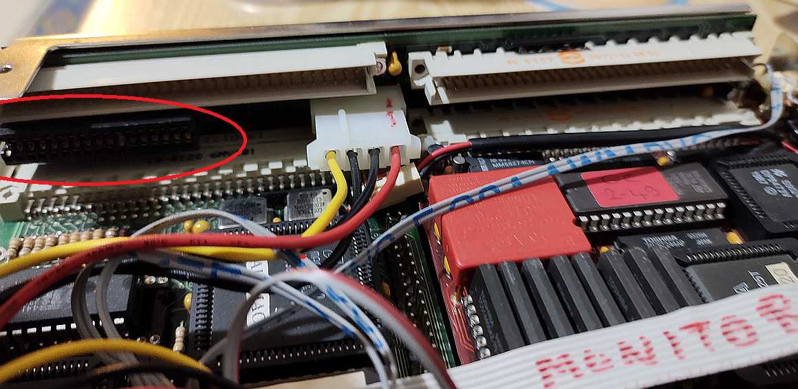

As my Aurora card has no QL-Style ROM port connector on the main board (and anyway there might not be room for the QIMSI because of the number of cables in the way even if it had a QL-style ROM port connector), it is replicated on the M-Plane backplane you can see in the first picture. Normally this is occupied by my old RomDisq simply because I had no other use for it these days.
View of Aurora's M-Plane
I removed the Qubide from the backplane (to avoid WIN name clash). Leaves just the Aurora, SuperHermes Lite, M-Plane, Super Gold Card and floppy disk drive.
The second picture shows the QIMSI plugged in where the RomDisq used to be. You can see the RomDisq resting loose on a cable in the picture, since I was too lazy to free it from its LED cable.
QIMSI inserted
QIMSI inserted
Obviously, for the Aurora's PS2 keyboard to work via the SuperHermes, you have to copy the ipcexts file to somewhere where it'll boot from. Seemed to work fine from QIMSI.
So it seems to work fine. The QIMSI is upside down in this particular system so you can't see the LED, and the micro SD card slot is beneath the board making it hard to see to insert a card if you want to change it.
Apart from that inconvenience, all seems to work OK.

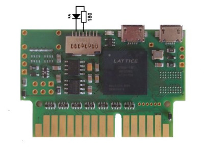

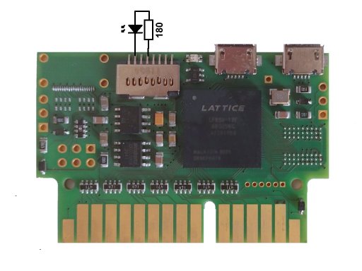

Right now, without design changes, an external LED would require soldering at the pads of the microSD socket according to the following picture:
With thin wires, not impossible for an experienced tinkerer. But only makes sense if the card is rarely changed. (Inisde a MinisQL case, replacing RomDisq, I would expect that.) Another option might be a microSD extension cable/adaptor.
