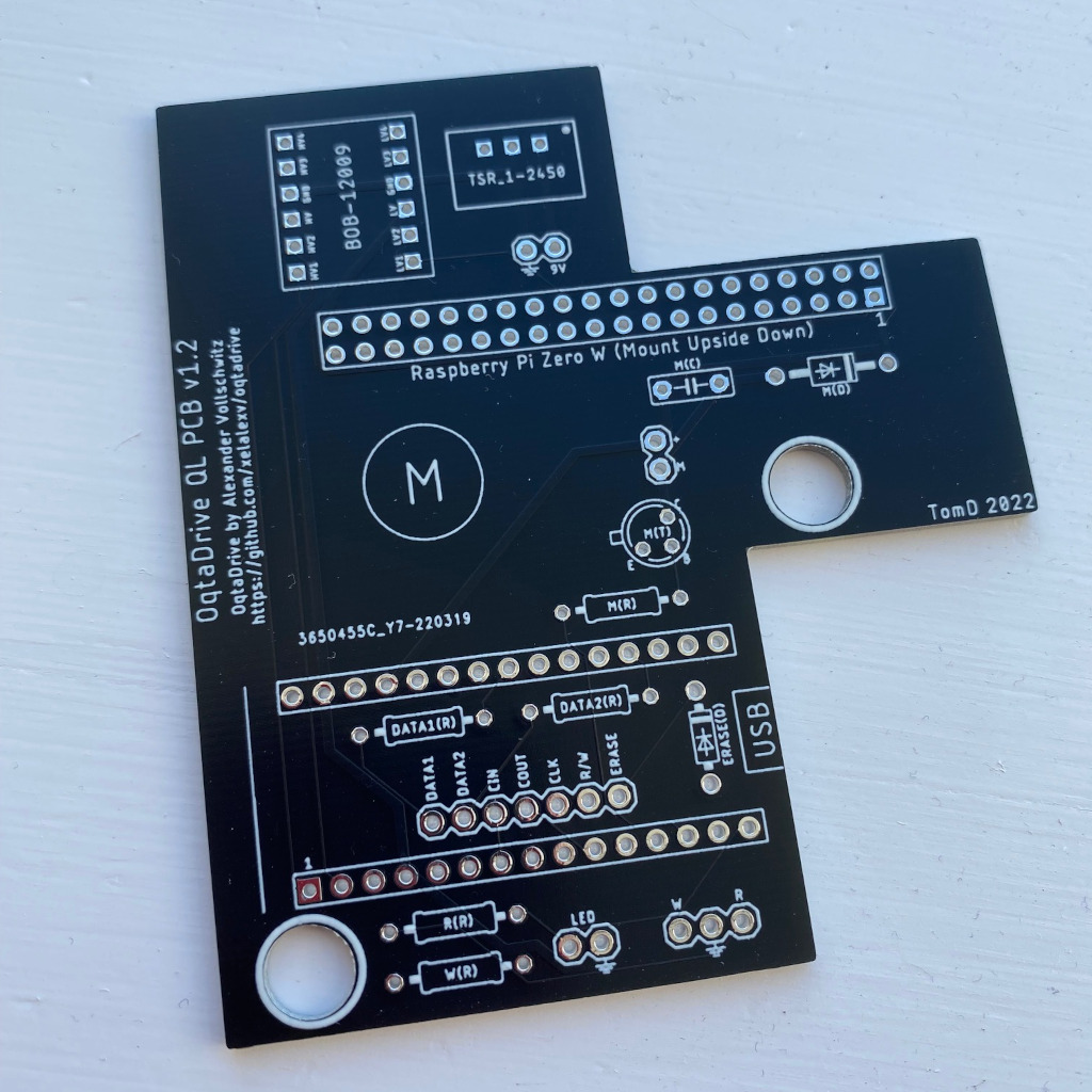

For those interested in building your own I've updated the PCB to v1.2. This basically shifts and rotates the Nano so it can be mounted in a socket rather than direct solder.
Shared project is on PCBWay https://www.pcbway.com/project/sharepro ... a1c12.html
I also have a few to sell as I got 10 in the order and only really need 2 or 3. £4 each if you want one in glorious black
