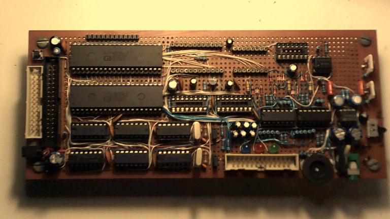

I was considering whether to knock up a QSound board a few years ago but instead went with something a bit more ambituous (2x AY-3-8910, 2x SN76489, YMF262+YAC512).
I considered modding QSound to use one the spare port B outputs to switch AY input clock from E clock to something ZX compatible. But if you decide to try something like it on your QSound replica it would be trivial to add support to my player, then you'll have access to a few thousand files :-)
(On my board I used 4066 cmos switches to configure ABC outputs, but it turned out to be just as easy to do it real time in player.)
poor quick photo
poor quick photo

Silvester wrote:I was considering whether to knock up a QSound board a few years ago but instead went with something a bit more ambituous (2x AY-3-8910, 2x SN76489, YMF262+YAC512).
WOW, this is too much chiptune in one card for me :-)
