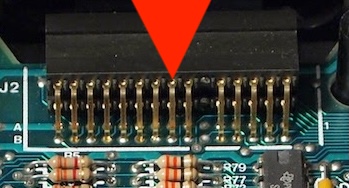

Would I be correct that the pin highlighted by the (rather large) arrow is the ROMOEH line please?
If so, is it the upper or lower pin please?
Tony
Posts: 2852
Re: Floppy Drives with TrumpMini3 Woe
The outer pin on row B is indeed the ROMOEH pin.
