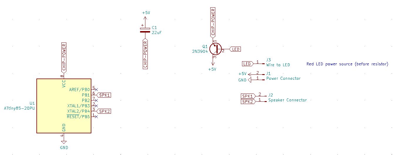

stephen_usher wrote: Mon Dec 11, 2023 11:40 am All you need is an ATTiny85 and a way to switch its power on and off using an output from the Pico. In the case of the vDrive I used the activity LED power to switch a transistor. The speaker is directly connected to two of the pins on the ATTiny85.

ATTiny85 chips are cheap (£1.50), add a transistor and it's less than £2.
Here's the schematic:
Replace "LED" with an output from the Pico and Bob's your uncle.

stephen_usher wrote: Mon Dec 11, 2023 7:02 pm ATTiny85 chips are cheap (£1.50), add a transistor and it's less than £2.

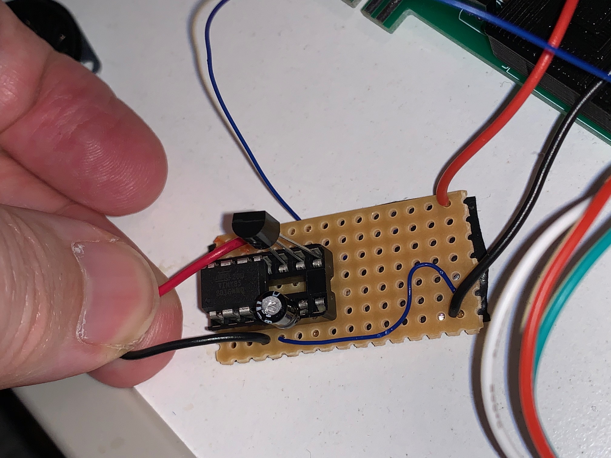

You don't really need a PCB. My first version was a bit of vero board, a 14 pin socket and some bodge wires.
