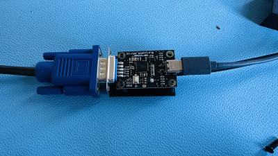

Marcel_X wrote: Mon Feb 17, 2025 8:00 pm It's is based on the Pi Pico or Zero, but decided to include all components on a single 4 layer 1mm PCB to make it fit between the pins of a D-Sub15.
Nicely done. There is also a way to place everything directly into a D-Sub case:
https://www.theqlforum.com/viewtopic.php?p=50519#p50519
Schematics, placeplan and Gerbers:
https://www.theqlforum.com/viewtopic.php?p=50130#p50130

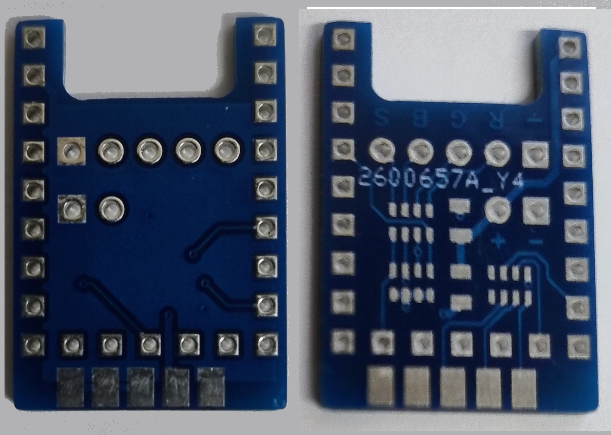

A while back, I got some PCBs made, but never got around to making the adapter:
I tend to get distracted easily...
But I was trying to use a Dsub housing, but is to small for the PCB, maybe have to use the Conec 16-001810E, but the unit price is expensive.
I like the new PicoVGA board, but I am not sure if I could solder the components, old eyes now...

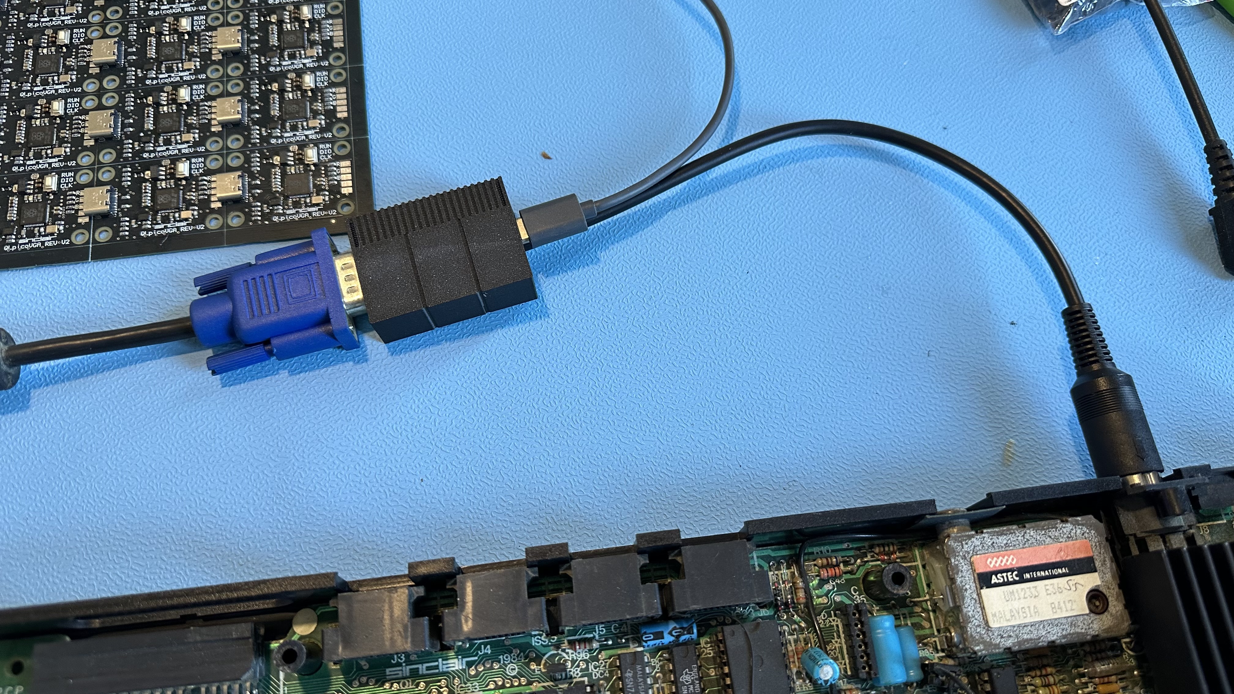

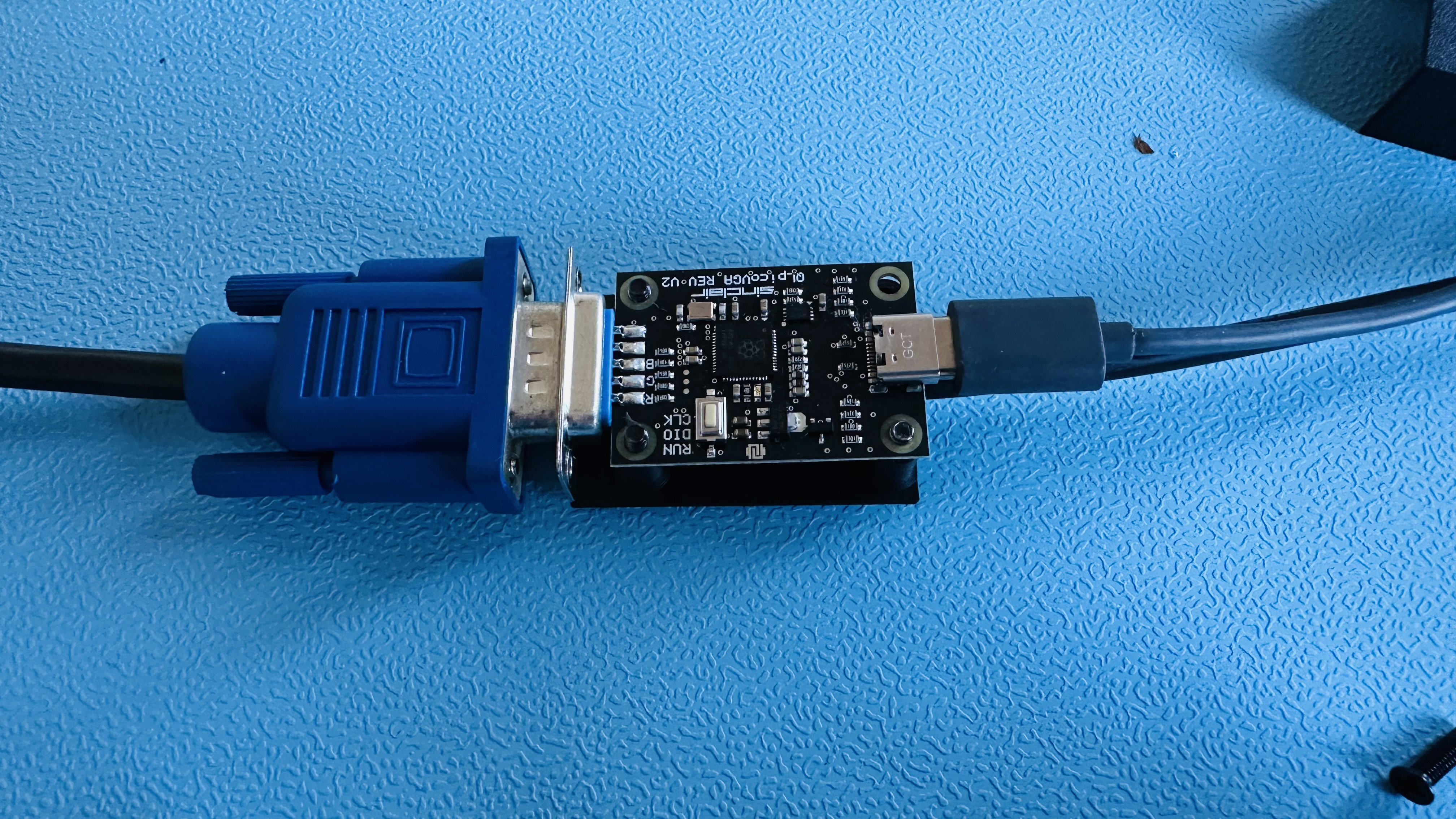

Yes... I am very tempted to do so! I have already redrawn the board and squeezed it down to 26 by 38mm.
Have to tweak it a bit more. And instead of using a pre made shell or case, I modelled one myself.
Printed one, just to see what it would look like.
I already printed the case and it is a lot smaller than the one I made first And a lot more QL-ish :D
@Peter, regarding the soldering, I would definitely add some additional solder to the fine pitch pads.
Just add enough flux to the board, a little solder on your tip and drag it gently across the pads.
Does it make sense to make one from scratch? Definitely not!!!! :P
Just having fun designing stuff!
Here are some pictures and renders. I will order a few boards soon. I just need three or four so I probably have a few left in case anyone is interested.
Exploded view
Exploded view
VGA side
VGA side
QL side
QL side
Side bij side

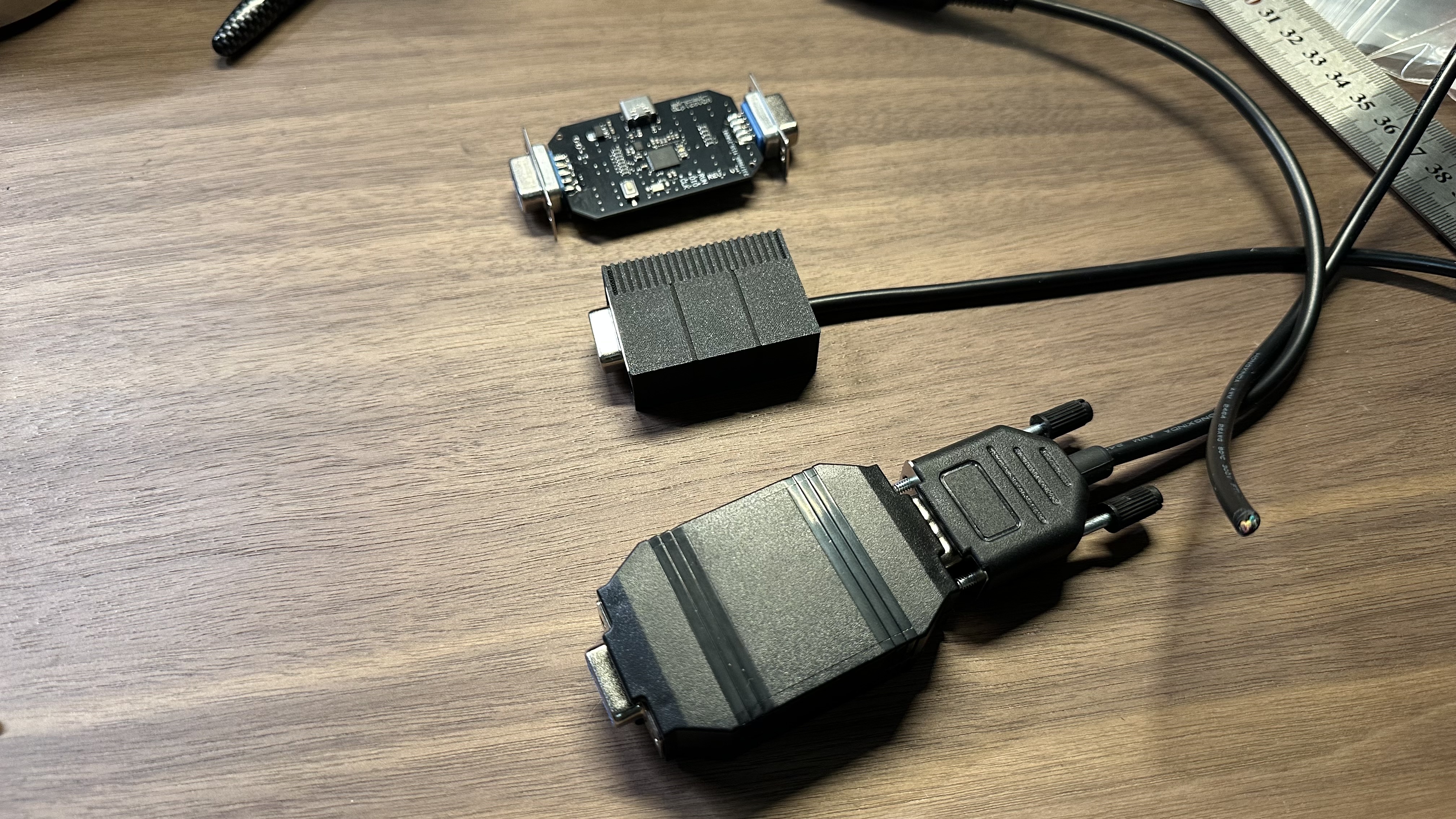

Couldn't help it. I had to do it... :D Made the QLpicoVGA even smaller than the previous version. And made a new 3D printed enclosure instead of using an off the shelf one by Hammond. That one required a DB9 and a DB15 connectors on each end. And another cable with an 8 pin DIN and one more DB9 to connect it to the Hammond enclosure. I think this new solution is far more elegant and has the QL "look".
Single 1mm board that fits perfectly between the pins of an DB15.
I can put the Gerber files on Github if anyone is interested. And the enclosure on Makerworld for those with a 3D printer.
