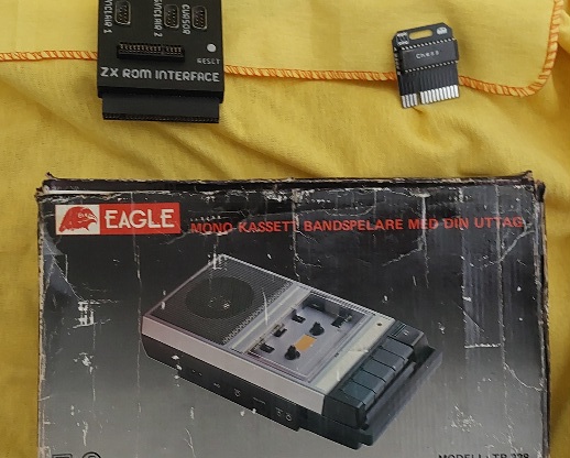

Thanks to supporters idea for exchanging my software with their no-needed hardware
They say tbey help me to further devlop my future projects(!), sw vs hw and received:
Eagle recorder for zx48k, zx48k rom i/f 1 and zx48k chess cartridge!!!

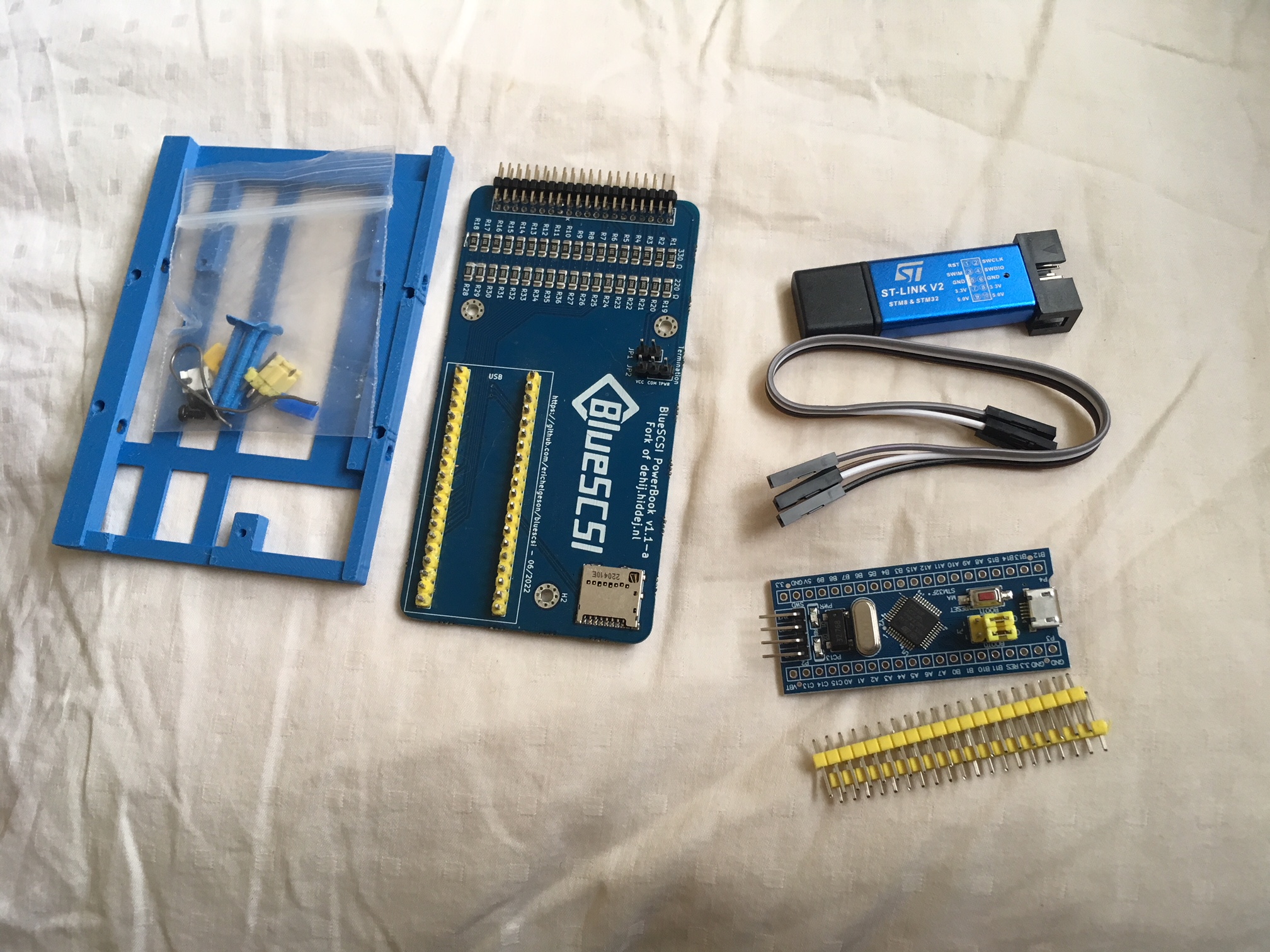

Not QL related, but hobby related. I bought a new Blue Pill (I've had the BlueSCIS for over a year).
I was finally putting together my older BlueSCSI (the one that still actually uses a Blue Pill) and because of bad solder I had purchased from AliExpress, I broke my Blue Pill. Excessive heat and constantly trying to get the solder to stick caused the pads and traces to go and so I was faced with losing the entire board. Well, I cut the Blue Pill out carefully since I only have a solder sucker and my iron only goes up to 450 celcius, which wasn't enough. I then ordered a replacement for under $3 (with the ST-LINK, which I now need to add a boot loader). With an unexpected $2 off and free shipping since I got to $10 for adding proper solder and other stuff, the screw up ended up costing 75 cents.
Of course now I need to configure it with the BlueSCSI software. The kit I got from Joe's Computer Museum had done all that for me. Doesn't sound like the simplest, since you first have to load a variant of the boot loader (and there are many, dependent on how the LED on the Blue Pill is connected). Luckily I've seen some good YouTube tutorials that at least get you through that part. Here's hoping I don't screw that up.
I will definitely test the new solder to make sure it doesn't require 400+ degree celcius to melt (it's 0.8mm and says 183 degree for melting point). I'm not terrible at soldering, though struggle sometimes with small stuff (or being too OCD and spending too log on something), but that experience had me questioning if I was able to solder at all. The other solder had claimed it was low-temp and the few things I did with it didn't make me question that, but once there was a lot of ground plain and other things taking the heat away, it definitively behaved differently from what I expected.
