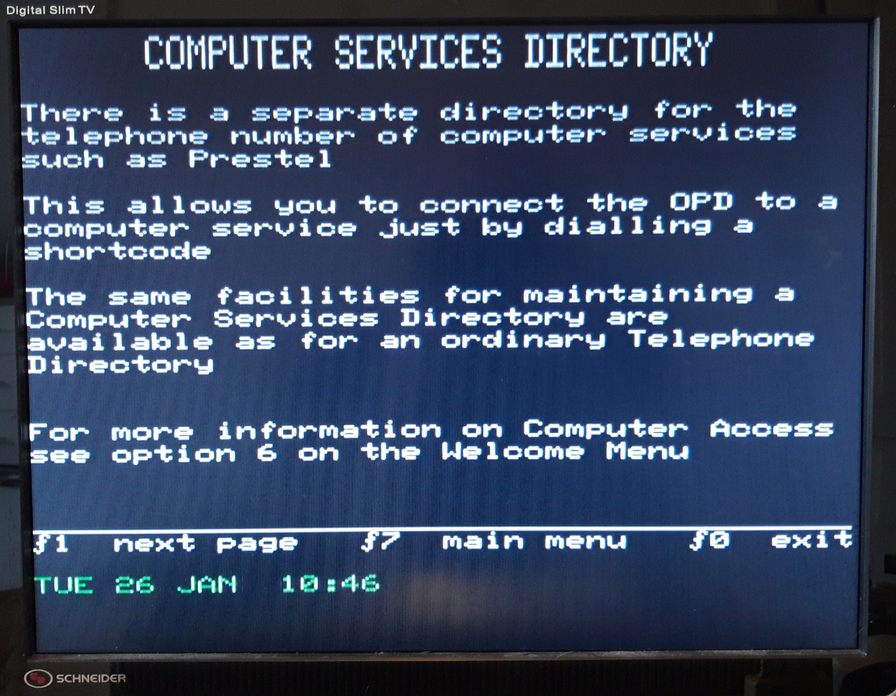

I have such a cable that allows me to use my Merlin Tonto connected to the appropriate voltages from a PC PSU and with a scart video output. I've looked inside but it's quite a spaghetti and would take a while to work out the connections (they all have black heatshrink on them and there is at least one resistor in there). I got it from a very nice man on Facebook called Matthew Smith who is from Scarborough and in his current pic he's wearing a red top. I seem to remember I had to change one of the chips within the Tonto to generate the correct video signal and it wasn't socketed so had to be de-soldered. There was also a jumper wire to add. But it works perfectly, here's a pic of a screen:
Posts: 1590
Re: ICL OPD
I posted pictures earlier in this thread of the IC that needs to be replaced in the video circuit - along with the link to the icl information that explains which chip is swapped for which other chip (74LS240 to 74LS244) from memory.
