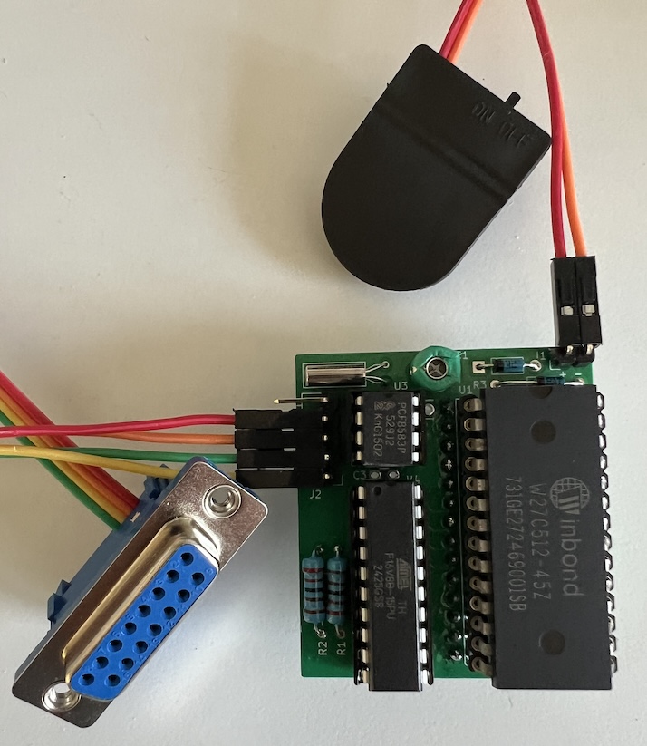

Built first test unit this morning, to try and take my mind off things
It works as a Minerva ROM ok and the RTC clock works as it should (other than running slow, which I assume will be fixed by trimming it?)
Don't know when I'll have time to explore the other functions more and the I2c functionality
Thanks for all the advise

looks good !!
I hope your mother will recover soon.

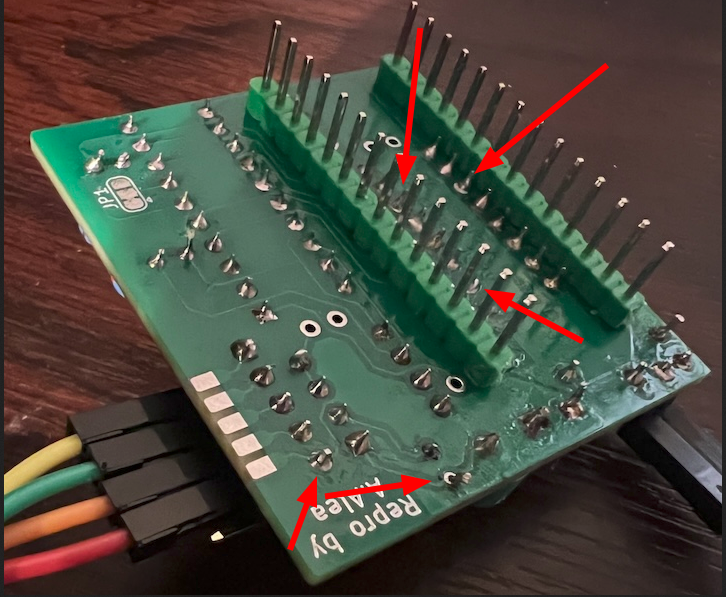

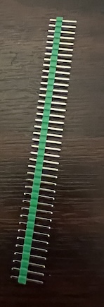

What sort of pins did you use for the QL socket? Can you post some pics from the downside?
Thank you.

I used the ones in the attached image
If I decide to make a board to fit inside a QL (It's currently attached to a Viglen external socket) I'll probably look for some with shorter pins. Will also have to skip the sockets I think to make it fit in the QL

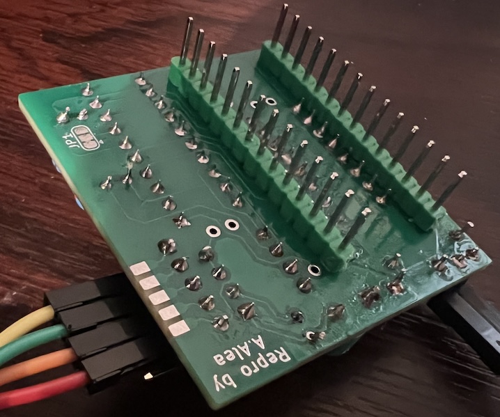

javier2112 wrote: Wed May 14, 2025 4:10 pm
Don't laugh at the soldering, I've never tried anything like this before!

t0nyt wrote: Wed May 14, 2025 6:47 pm Don't laugh at the soldering, I've never tried anything like this before!
Very good job,
By photos, I would check out (or try to improve the soldering of the joints marked on red), just in case.
Try to heat more the pad than another thing and touch with the soldering wire the pad. When it smelt get stick to the lead too.
Very very good soldering really. congrats.
Finally, do not use those type of pins for QL Sockets. They are too thick and will spoil the sockets (in case you would want to use the previous ROMs), instead use rounded pins (try to use high quality from Mouser or RS)

We can already see a vast improvement in your soldering, well done. Popopo has got it with the bad joints already!
