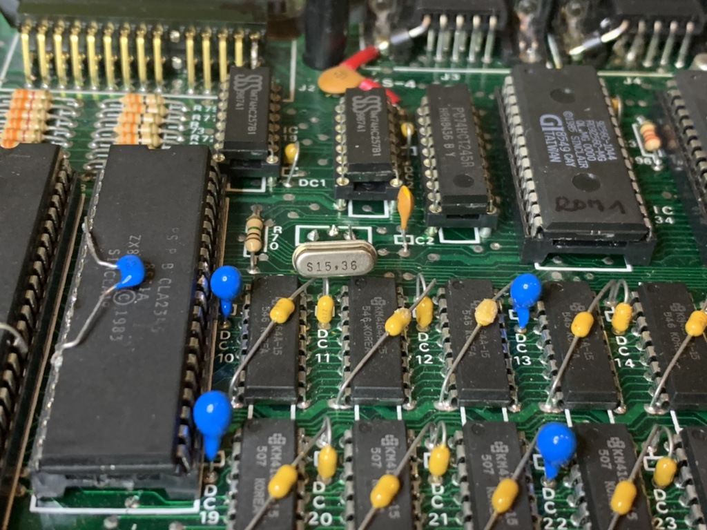

I removed the crystal of my most abused QL (by the previous owner!) and wanted to feed an external clock, only to note that I do not have any source capable of doing so. Even the very expensive NI DAQ hardware I have here from work couldn't meet the specs :( But fortunately I had also ordered some 15.36 MHz crystals and they already arrived today. So put I that one in:

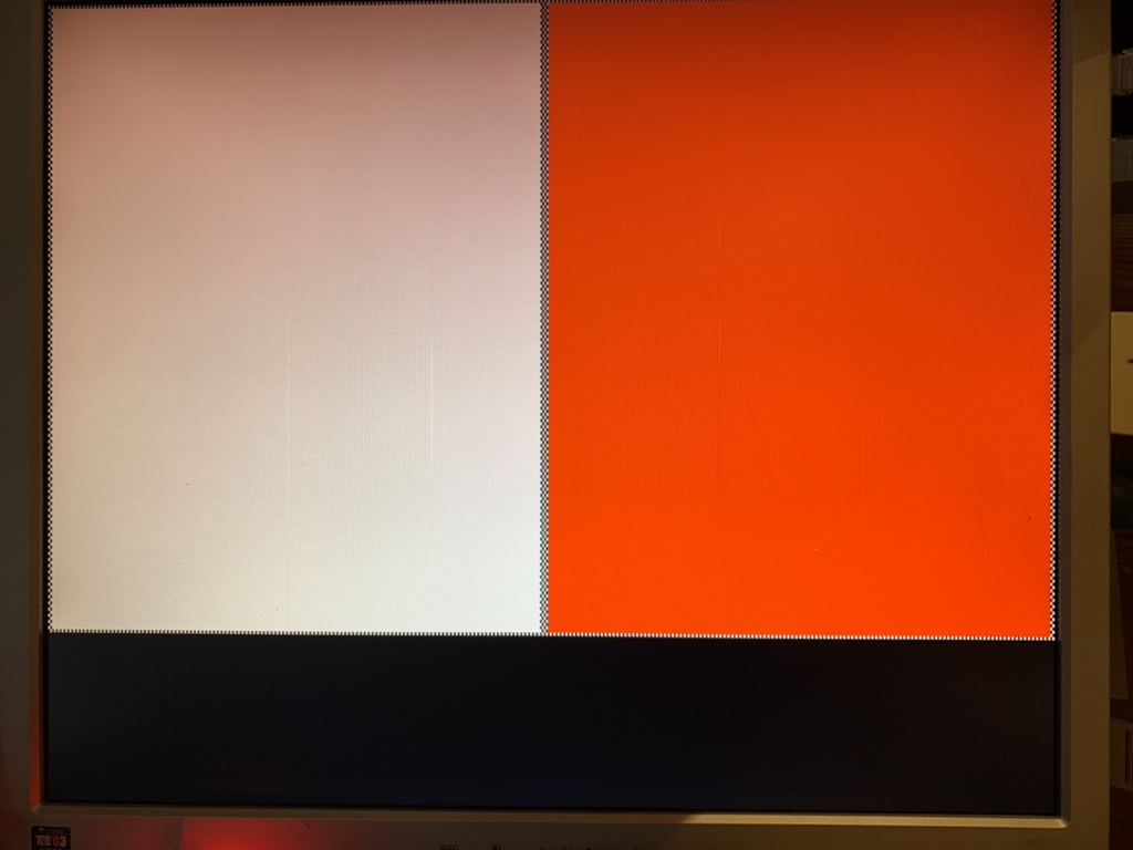

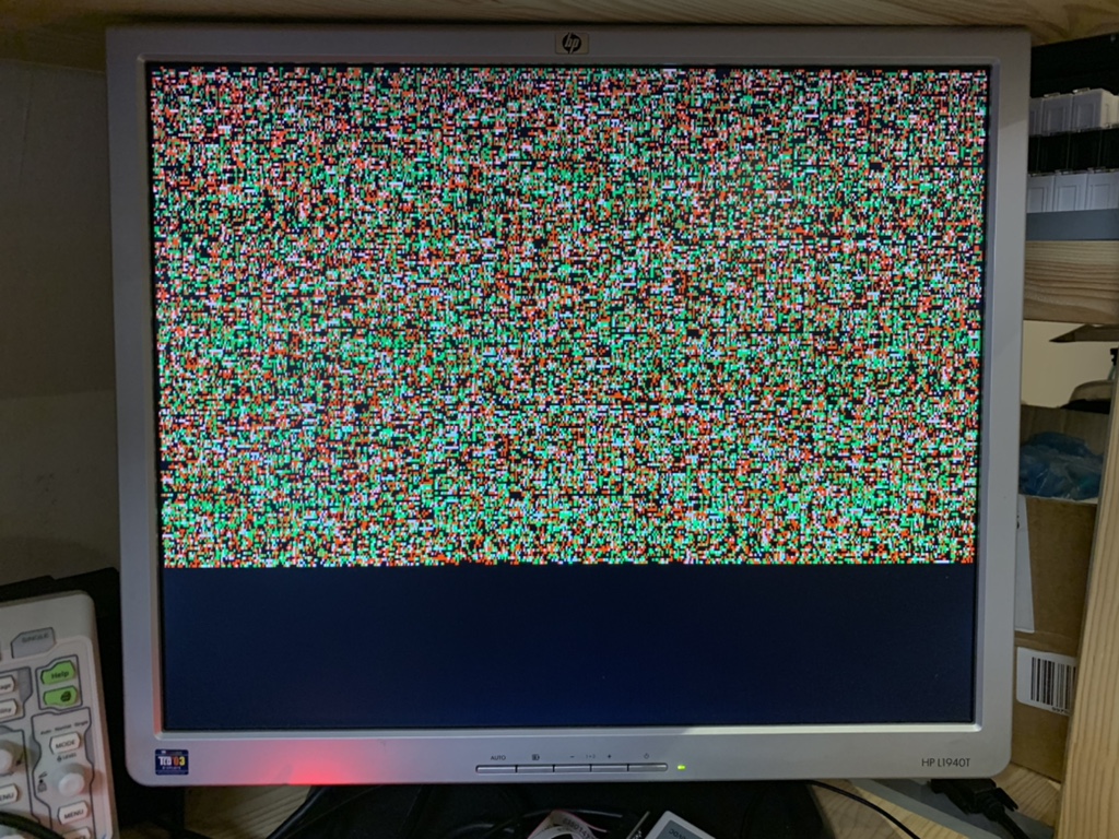

Then I checked out an existing QL-VGA with it, the effect is very similar, just even more "sweet spots" and more pixels missing on the left side (something I missed during inspection of the original picture):

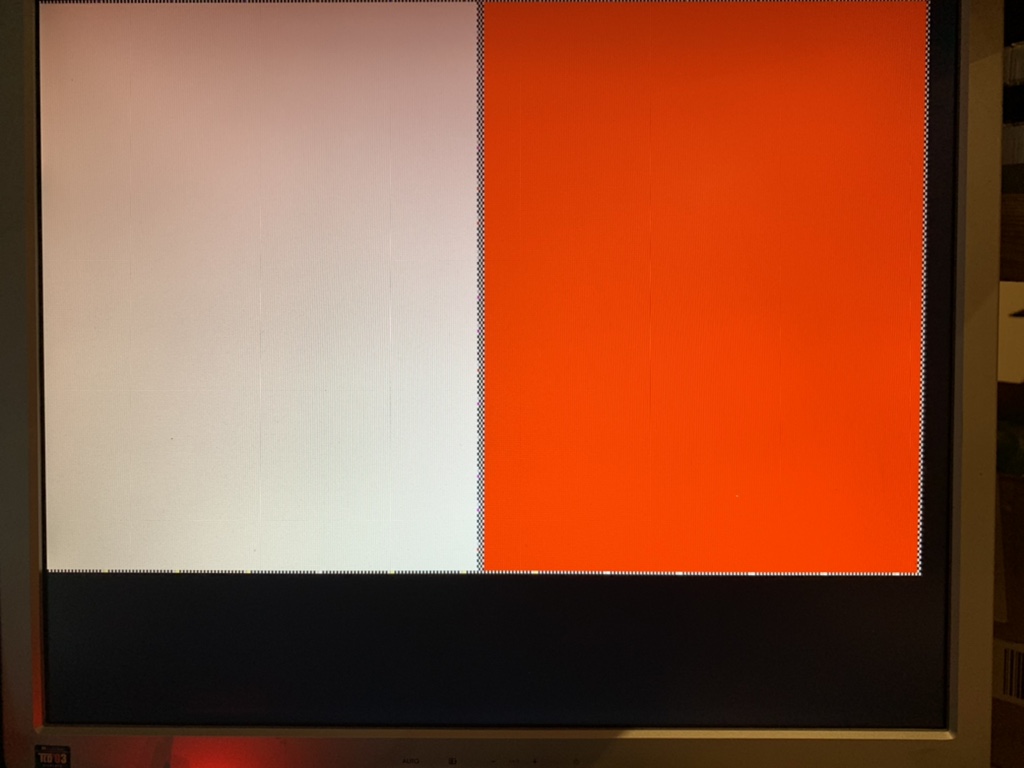

Then I applied my fix and voila, picture becomes rock stable despite the 10.24MHz pixel clock:
So I'm fairly confident now that I can get US QLs to work, too, though probably not in NTFS mode (so "normal" OS like Minerva might still be required). I guess the additional board just helps with the slew rate and doesn't affect the clock otherwise. Just a pity the increased clock wasn't documented before. Or rather anything regarding the NTFS QLs...
By the way, the QL obviously boots fine and even F1/F2 are accepted, but ultimately crashes when accessing the Microdrives.

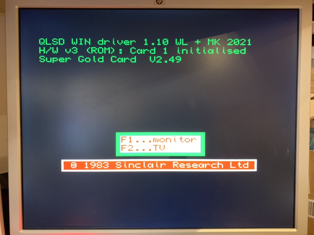

The CLA2345 of later European QLs have the NTSC mode implemented, too, just at a slightly lower frequency due to the different crystal. But this way I was able to implement support in QL-VGA for it. Not that it makes much sense, the QL only has 192 lines in NTSC mode, the rest will be black, but it's nice to have a complete solution (hope my maths works with the faster crystal, too ;)) This is what the JSU ROM looks like, it boots completely in NTSC mode, so F1/F2 is much higher up:

Yes, "monitor mode" has full 256 lines.
So on JSU QLs the F1/F2 selection actually matters as there are 4 possible modes. Issuing a "mode 8" after booting with F1 stays in monitor mode, i.e. 256 lines with 8 colours, while selecting F2 from the start gets you 192 lines in 8 colours.
