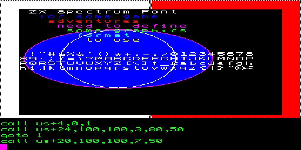

I have consolidated my coding, so I now have this, leaving filled CIRCF, ELIPF, in favour of common FILL. It is not much, but can possibly become a basis of something more interesting. Still cannot rotate ellipse nor do arcs. I can observe that circles in MODE 8 become ellipses, right?

White curve is meant a circle radius of 50.
Circle is Elliipse
Circle is Elliipse
Tom

Cicrles should appear as circles in both mode 4 and mode 8.
However, you have to bear in mind that the number of X pixels in mode 8 is half that of mode 4 which is probably what is causing the issue.
Posts: 3192
Re: SCREEN1 = SYSVAR @ JSROM
What might be a bit confusing is that SuperBASIC actually hides this fact in its pixel coordinate system - It still appears as if the QL had 512 pixels in x in mode 8 - SuperBASIC just halves the x coordinates before drawing, so if you want to mimic this behavior you should do as well.
