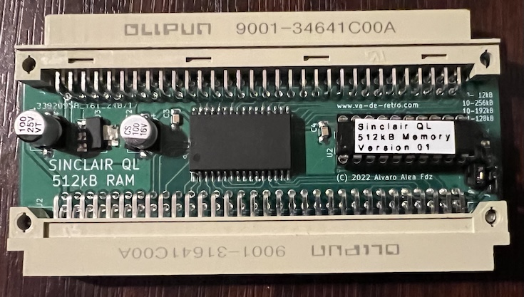

aalea wrote: Thu Aug 07, 2025 5:45 pm First of all, this is a modification of my interface, I did was not aware that this version exist, and I'm not sure what it do or what kind of revision the maker use to do it, but assume that this is the last, based on the jumper of the top. (btw f|@¬½k the only things that the License of the PCB request is not change the notices, author, copyright, etc... and provide sources, and none is fulfill).
That is my fault, I made that version and havent pushed to git yet as I was hoping to finish a smd version version and push that. SInce im slacking on that will push the as-is to git as soon as I can. Coming back to the change, there is/was pretty much no modification to the schematics, only JP1 as a pin header and another pin to select the bank on the rom, besides that just ground plane and some minor routing. Evertyhing shall behave the same as original work.
Ok, please, you can use the release option of github, publish it as you sell it, and later make a release of the smd version.
I'm Ok with the modifications, please, do it, I got ideas, I will incorporate the jumper for ROM bank switch in my next revision.
But if somebody bought (example in a flea market) you card in 10 years, is better if he has a place with the documents and changes.
Now that you confirm that there is no changes in the schematic, is one variable less in the equation, and can continue to investigate.

t0nyt wrote: Thu Aug 07, 2025 6:09 pm What I did was put a normal 256k expansion board between the QL and MT3 and that's when it went crazy dumping a ROM to screen
The only "normal 256Kb" interface that I know is from Quest, but I do not have the schematic, so I don't know if there are any missing line or something in the expansion connector that cause the problem.
This shall work, trump shall detect 384Kb, and continue to work (yes, trump can detect 384Kb or any other memory size and not hang,at least).

Sorry, by "normal" I mean't a board configured to 256kb which is not your 256k+ board for the MT3
It was this one

t0nyt wrote: Thu Aug 07, 2025 6:59 pm
aalea wrote: Thu Aug 07, 2025 6:35 pm
It was this one
OK, to be clear, this only happens if you had a custom GAL code for that.
there is not (at least with my GAL code) "normal 256K", any other size different from 512Kb is always +, is always to install as a second card.
Because always, in any case, the middle 512Kb memory area is dedicated for RAM, I only consider this option, there are no any interest in use other size of ram, (in the past, there was quest 256Kb, or Trump ACE 256Kb, but is a question of money, ram was so expensive, that made a 256Kb, has sense, but no now-day).
The other sizes, +256, +128, +192, are always refereed to the last part of the ram, and need to be use at same time of another 512Kb, and the purpose is to be shared with other interfaces that need also memory space, so you can have different hardware interfaces at same time (unfortunately there is other factor that has influence, but I'm been able to have Minerva + mICE + 512Kb + 192Kb + Qbuide + Qsound + Qdisk/trump, all at same time and just work (well more or less).
