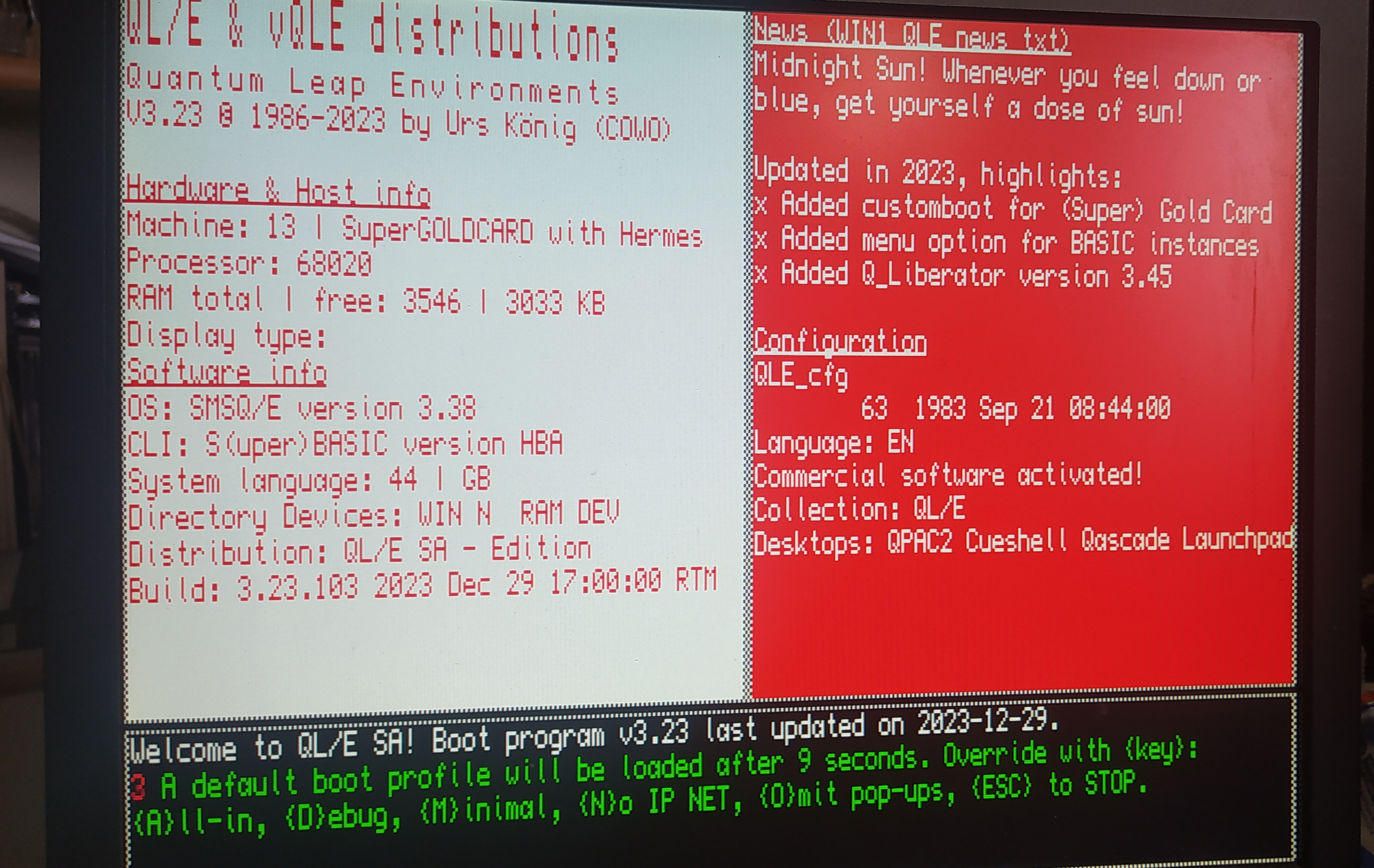

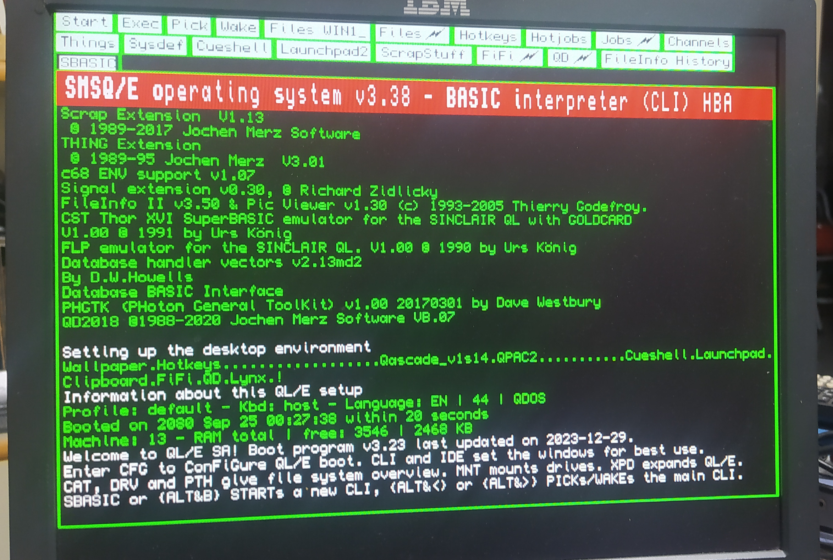

This is the situation:
I use the compiled from the source files SMSQE at the smsq\smsq\aurora directory and the modified to at some level simulate aurora QLion core.
I boot to the smsq/e and it is recognised as a super gold card with hermes machine 13, print disp_type returns 5 = aurora QL mode

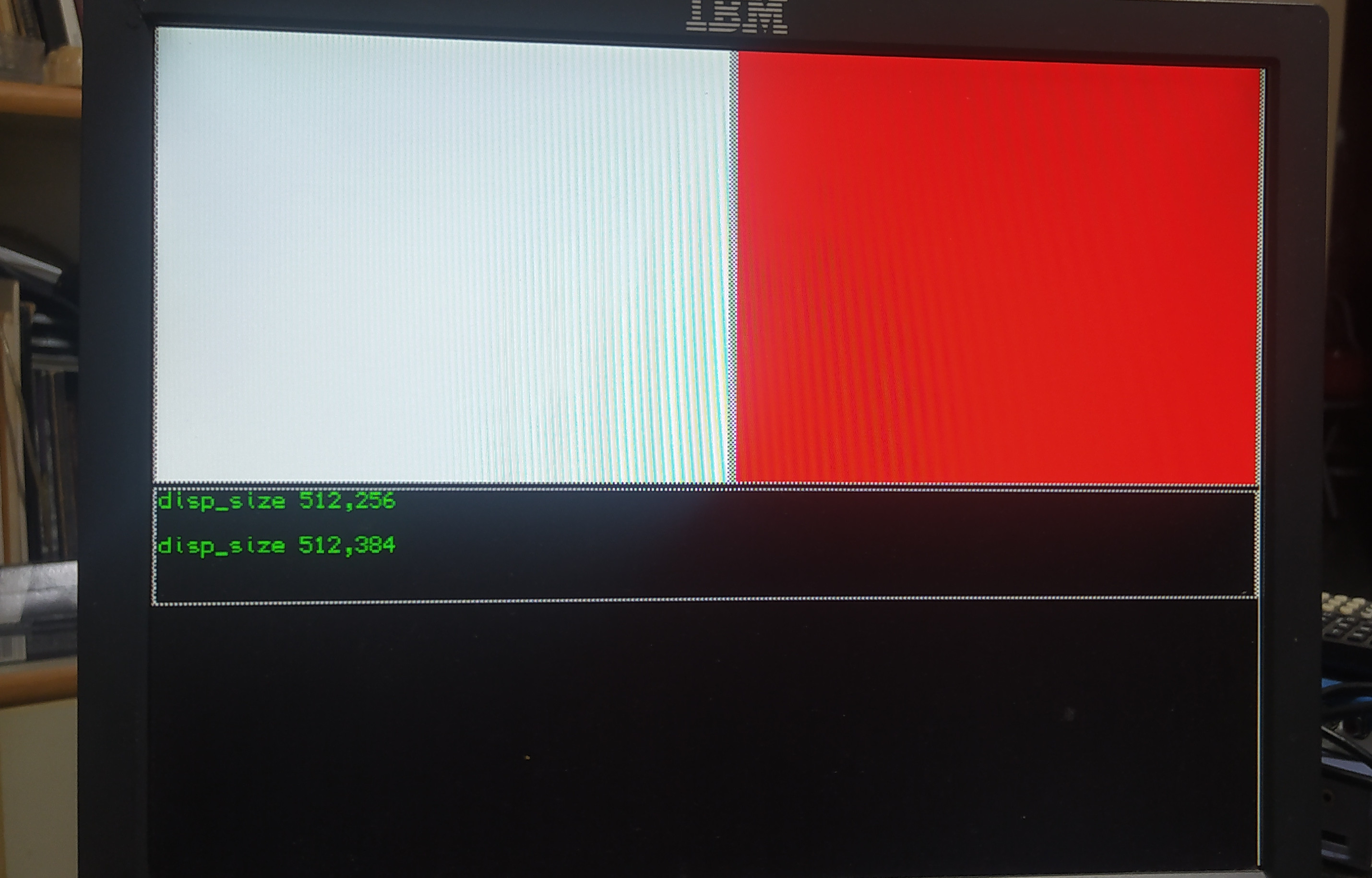

Then when I give the command disp_size 512,384 my card switches correctly to 512,384 reading the aurora registers but smsq still accesses the 512x256 area.
now I wonder, do I have to redefine the window ?

When you load PE and start an application, can you then move the window of the application to the lower (black) part of the screen?
Looks ok to me, but I am not so familiar with the screen things.

Re: QLion Gold Card
Yes it works, just needed to redefine the windows, here at 512x384 I want to see if I can get 1024x768 now
It looks it needs some vertical shift

Yes I moved a window and it goes all the way down, it's okMaskenlos wrote: Sat Feb 08, 2025 5:47 pm When you load PE and start an application, can you then move the window of the application to the lower (black) part of the screen?
Stephan
Leon

The definition of the QL windows #0,#1,#2 is set to 512x256 at 0x0 is all version of SMSQ/E, as you have found out the windows can be redefined by the WINDOWS command for the that channel or use the WMON ,x,y ( note the first comma is required as this was a MODE parameter, not supplying it uses the existing screen mode) or use Easyptr WMOV command to move the 3 channels.
