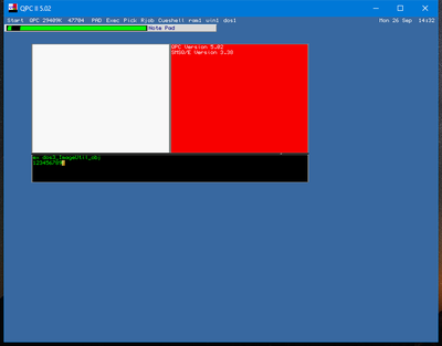

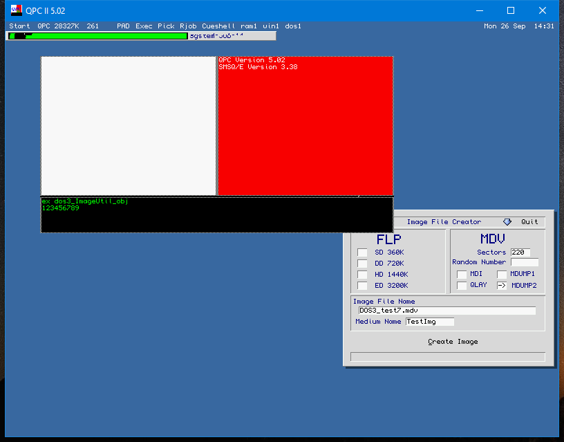

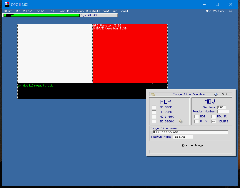

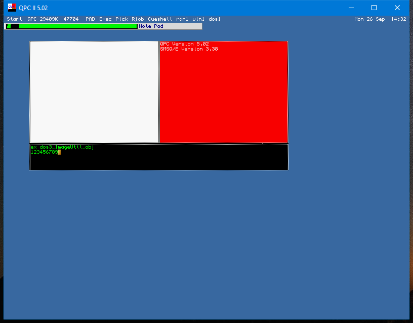

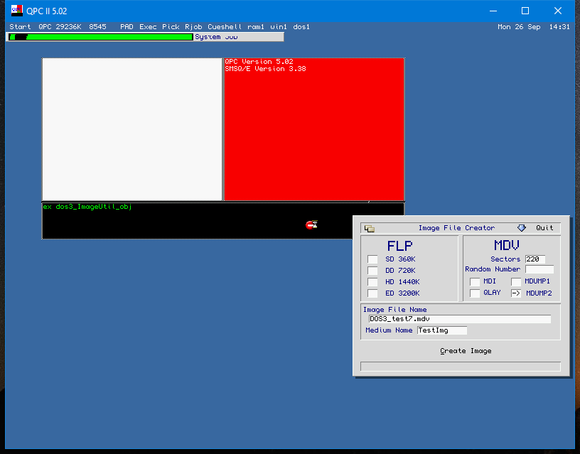

Hi, It's me again. With another question.
I have written a program in EasyPtr, and compiled it with QLiberator.
I can start the program, and move it about the screen fine. But I cannot right click back into Basic. I can CRTL-C back into Basic. And if I type something Then right click, or CTRL-C back to my program. What I have typed into Basic disappears. Then if I quit my program. The text reappears. I'm sure it's something I am doing wrong with OUTLN.
How can I set this up so that I can switch in and out of my program without messing the screen up.
Other PE programs seem to be able to do it.
