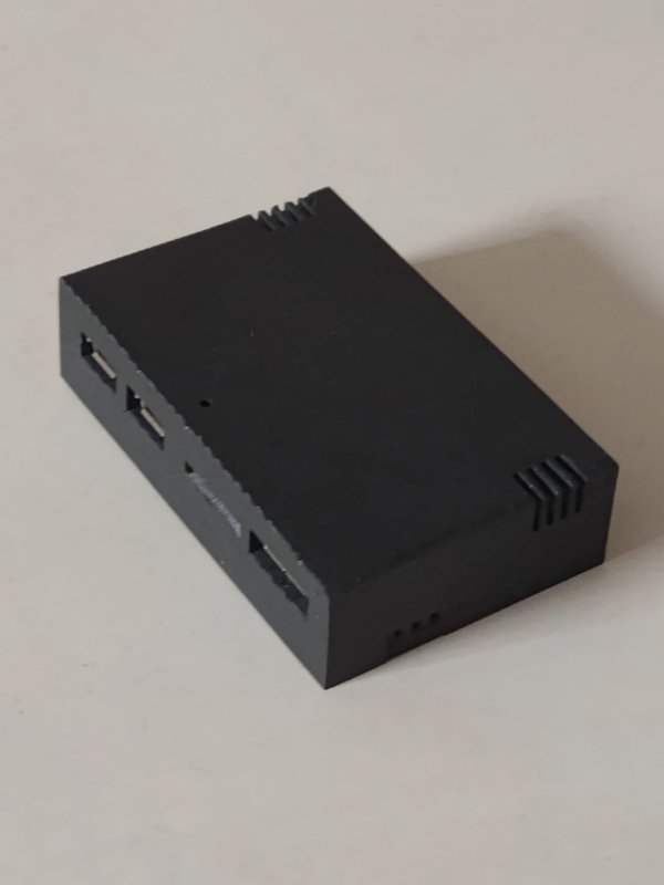

Looks great, I can get excellent SLA 3D Prints in Resin, very smooth surface, see my posts on QIMSI case: viewtopic.php?p=53386#p53386Peter wrote: Wed May 29, 2024 10:24 pm Back on topic: Probably the smallest cased QL compatible at the moment
56 x 38 mm
