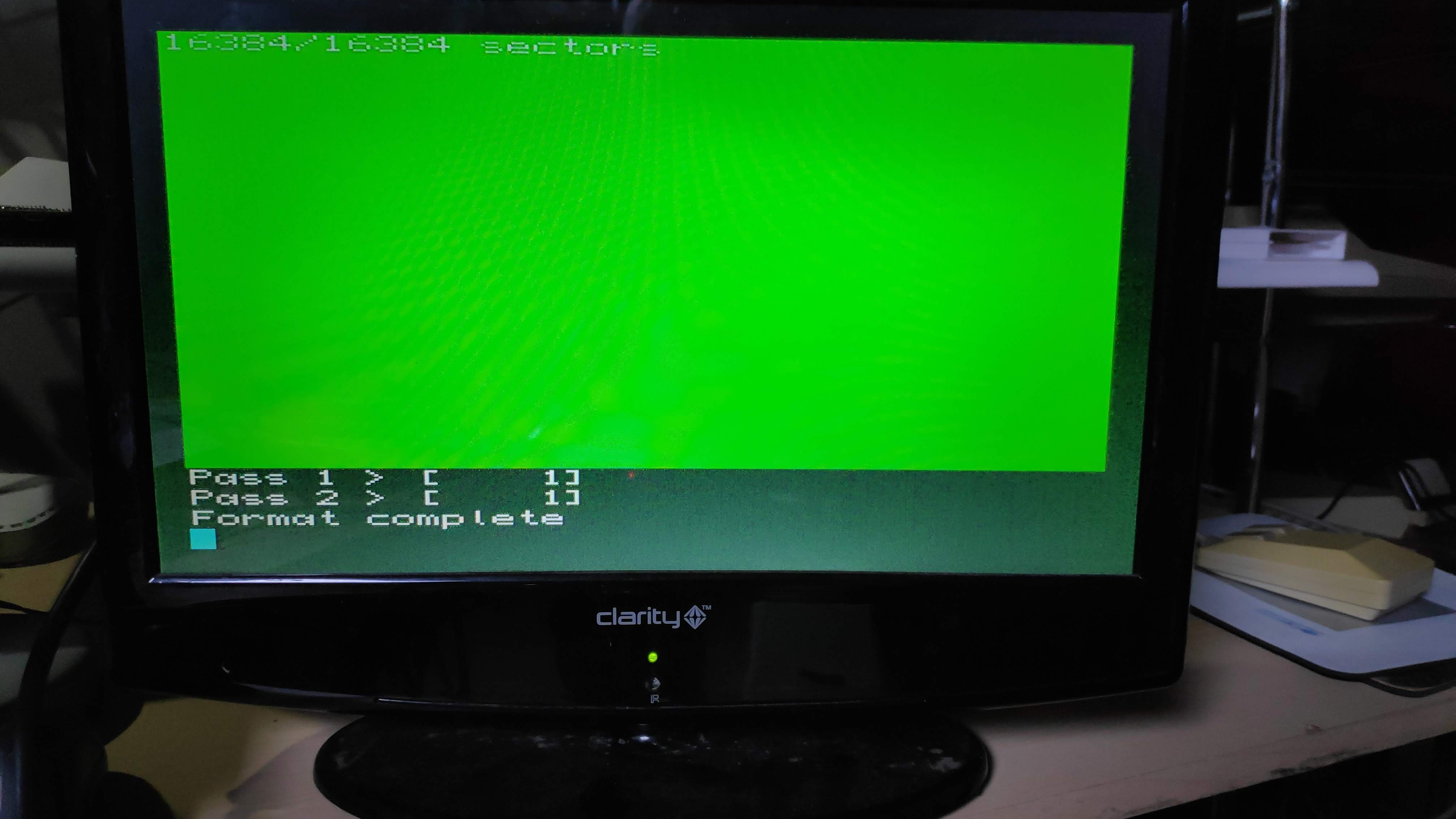

Success!!

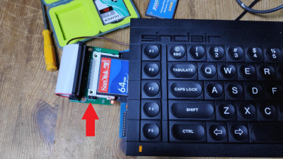

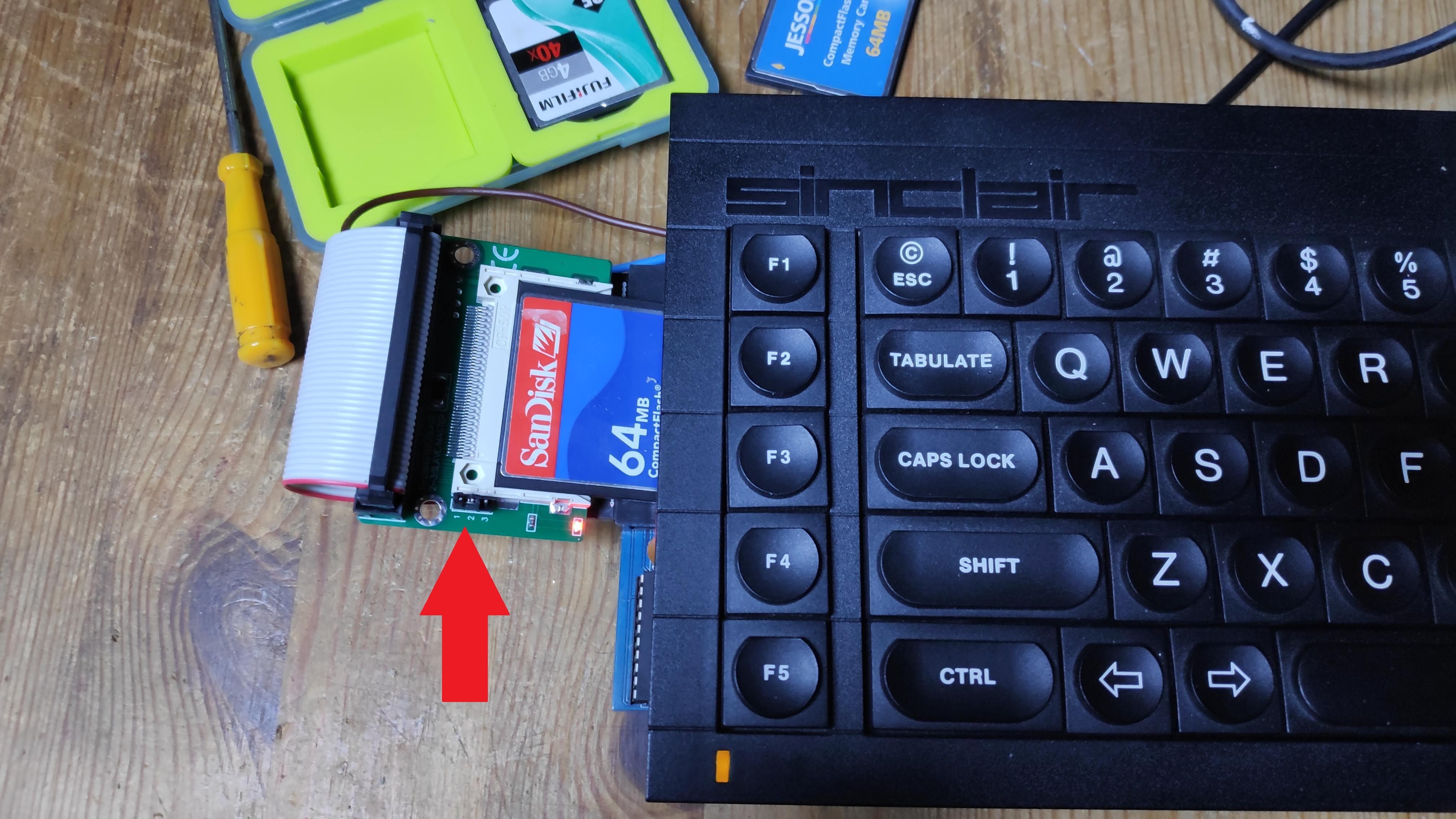

The intermittent problem is resolved. It was a loose master slave jumper a slight bend on the pin now gives a snug fit for the jumper. It boots consistently with the CF card enabled and working. Amen!

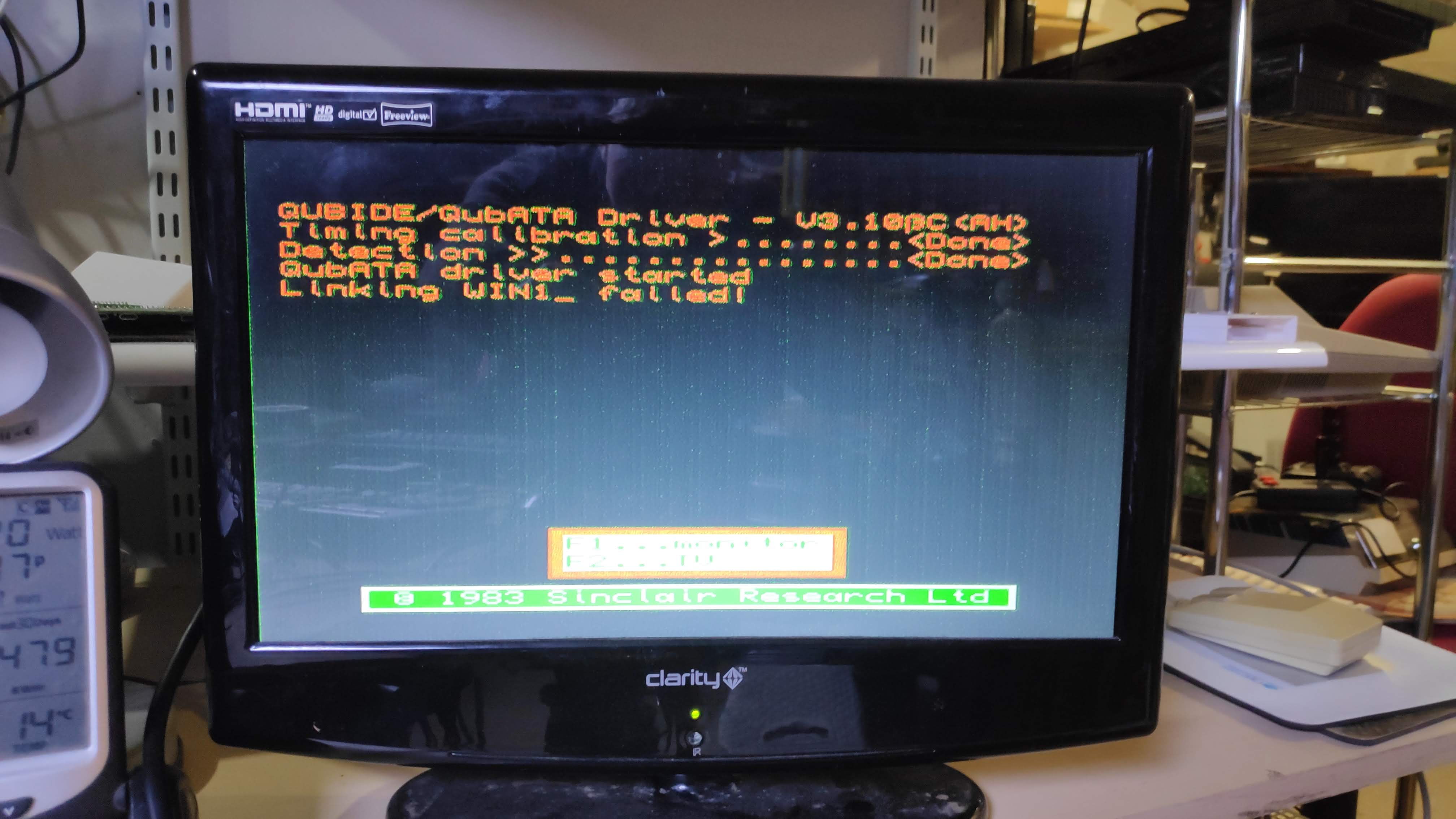

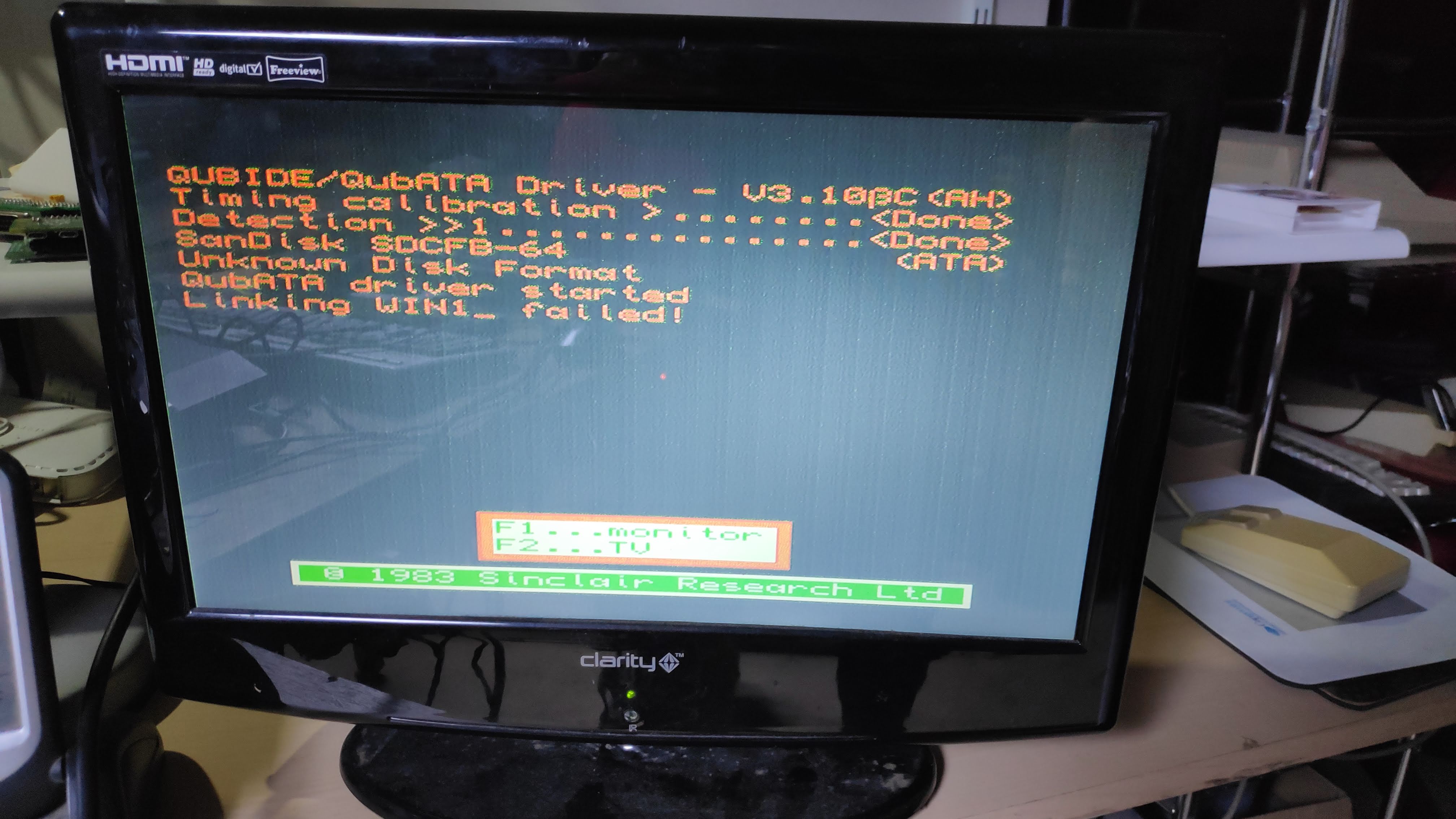

The boot looked like this when Card not correctly detected and hence the "not found" messages for the Win_Disk commands

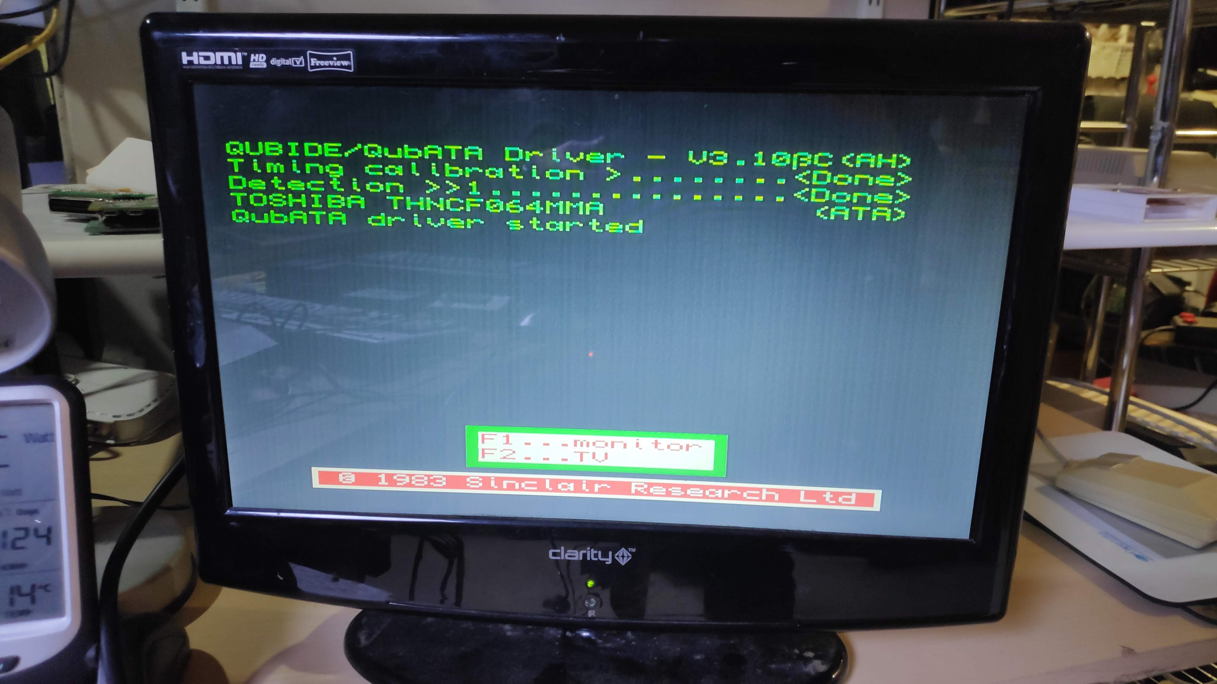

Card detected
