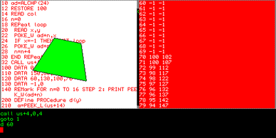

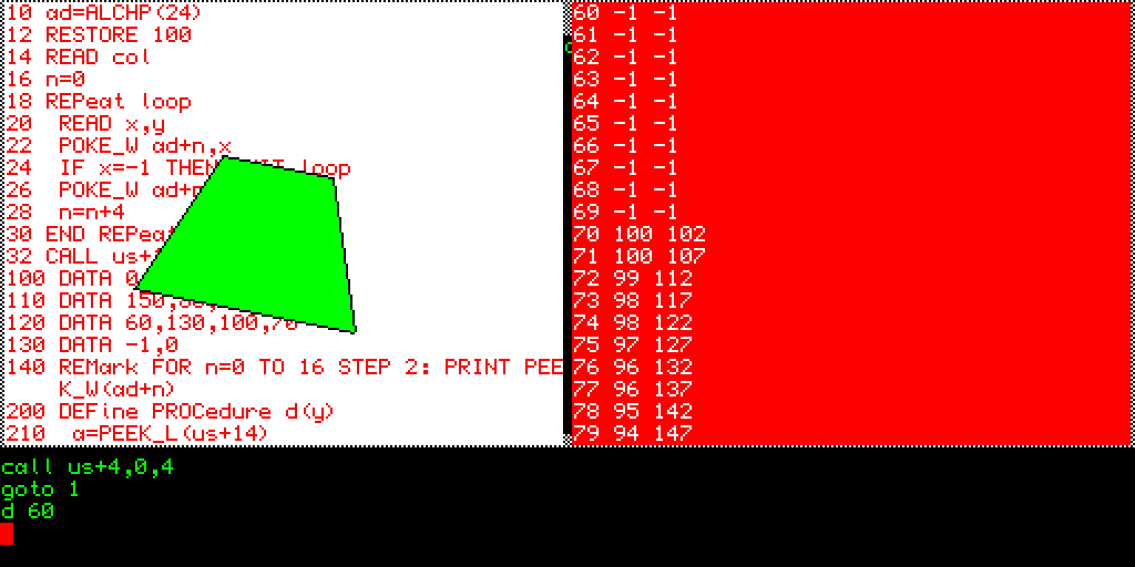

My attempt with scan filled poly, closely follows the above `pseudo code'. I use copy of display control, to toggle bit0 to mark fill 0/1 (on-off) state.
dctl     dc.b     %00000000         ;Display control copy
         ;bit7=$20000/$28000
         ;bit3=mode4/8
         ;bit1=blank
         ;bit0=fill0/1
Filled Polygon
Filled Polygon
Tomas
