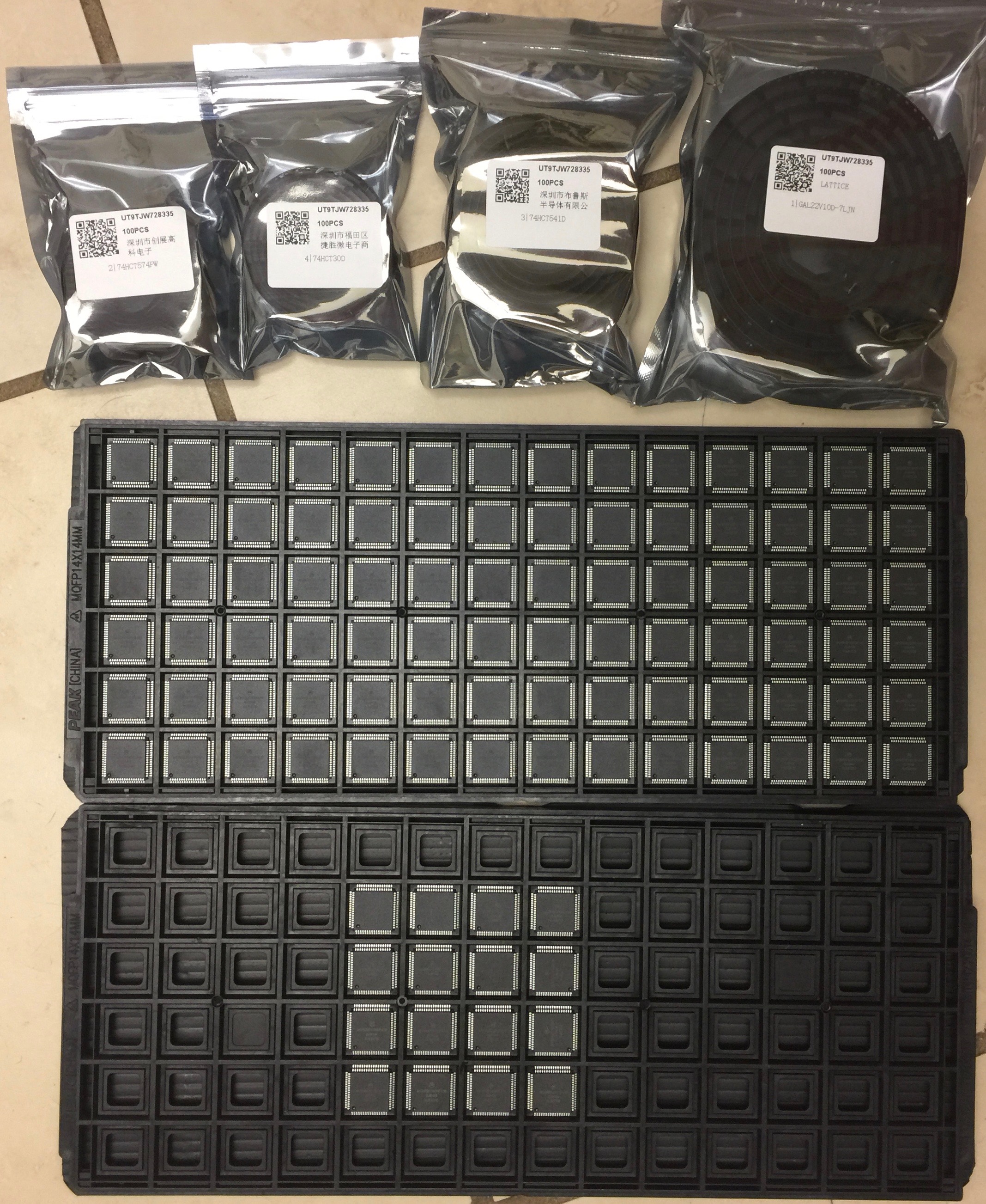

Today's component delivery for Issue 8.
100x 74HCT574
100x 74HCT30
100x 74HCT541
100x GAL22V10
aaaaaaand...
100 68000 cpus.
Let's check the countdown!

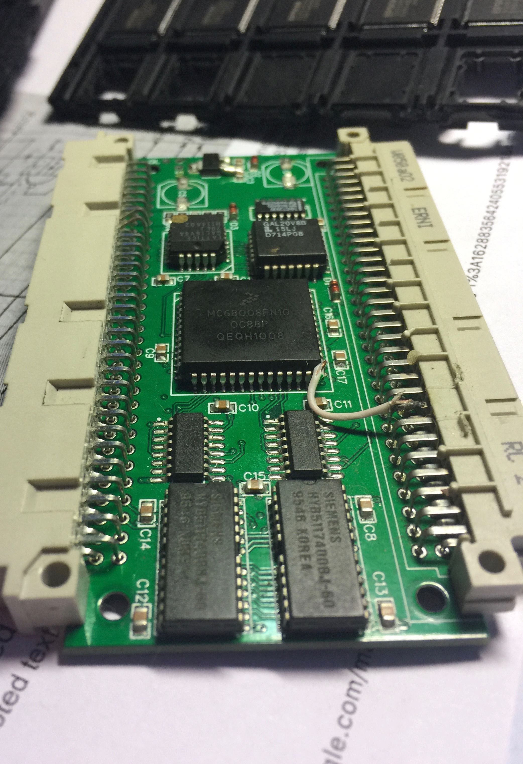

4M card coming along. This is the previous version, but it boots. Mostly ;)
The blurry ICs in the background are probably the most exciting element of the photo, but let's just save that for another day.
