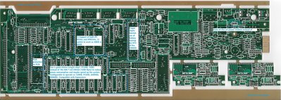

Peter wrote:
Nasta wrote:My gripe with the motherboard would be components that are problematic to replace or remove when they fail (in this case it would be RAM), and signal integrity. After all I just re-used the 8302 and IPC on the Aurora :P
Yes, a QL motherboard replacement for obsolecence, signal quality and repair reasons could make more sense than I first thought.
Probably there are a lot of non-working QLs with intact black box, CPU and microdrives. If I one can buy a replacement motherboard, simply re-seat the 68008 and voila, system works, this could sell well. However, I think that success would depend on a strict "retro" approach, i.e.
Yes, I think such a replacement motherboard would bring back many broken QLs back to life and with some design fixes and lessons learned applied, the thing would be a more stable computer.
Some ideas for an issue 8 motherboard
Highres Version can be found here:
http://www.sinclairql.net/srv/Sinclair_ ... _ISS_8.jpg
QL forever!
Urs
