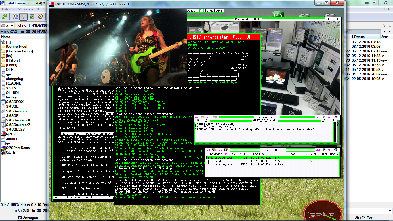

OK, I couldn't help myself. I wrote a quick&dirty movie player including sound: https://www.kilgus.net/2016/12/05/qmovi ... ie-player/ (135MB). Just start the QPC2.exe and it should work, no configuration necessary. Other platforms will probably not work anyway, no idea, you get into strange territory with files this large. I've tried copying the movie to a WIN device and failed, so it is played through the DOS device.
The movie file is some 320MB and contains 2 minutes of concert footage shot by me, so the player has to stream 2,6MB per second. I can now say with certainty that the system is not fast enough to decompress this amount of data on-the-fly, neither bzip2 nor gzip worked without major delays.
Source is included. Have fun.

mk79 wrote:Source is included. Have fun.
Great stuff (both the band and your work), Marcel!
Amazing how little code is needed (EXE size is 336 Bytes) to let SMSQ/E play videos! Windows and even Linux are so bloated those days, to get a tiny task done, almost everything goes in the hundreds if not thousands (references, declarations, files, megabytes) nowadays. The simplicity of our OS is what keeps me sticking with the QL.
Integration of QMovie into QL/E or any other distribution or personal environment is simple. To have QMovie_exe handier I would like two changes:
1. Input parameter should be either a channel or a filename
2. Additional parameter to pass the desired output, e.g. CON_480x270a16x36
I know, Marcel is challenging us to do such tiny changes on our own, but 68K Assembler is not my premier discipline.
QL forever!
Urs
QMovie playing Maidens, loosely integrated into QL/E v3.16 wip
QL forever!
