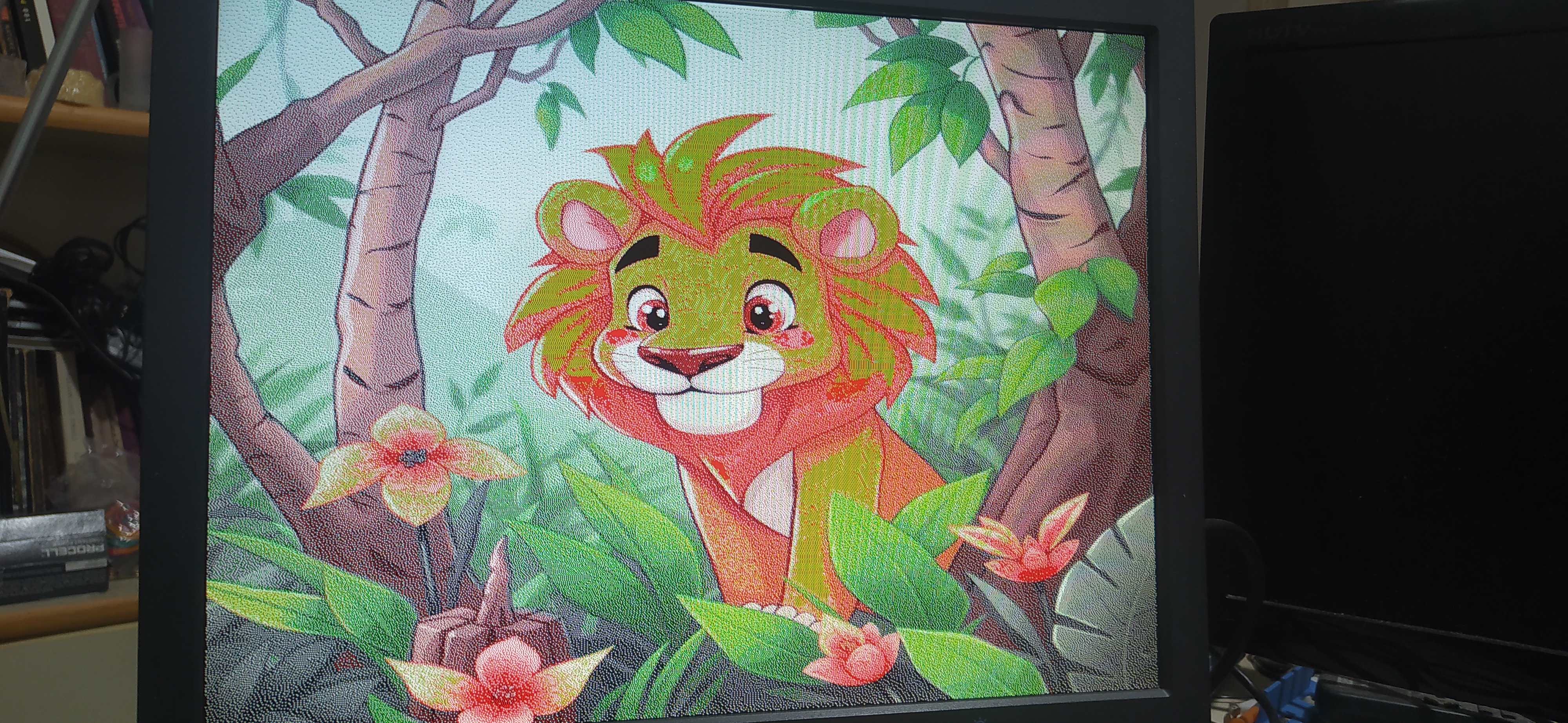

Great result!
Re: QLion Gold Card
Posted: Mon Feb 03, 2025 1:46 am
by lliont
Thanks, and 1024x768 4 colors
Re: QLion Gold Card
Posted: Mon Feb 03, 2025 8:45 am
by Pr0f
Amazing that's only 4 colours!
Re: QLion Gold Card
Posted: Mon Feb 03, 2025 8:59 am
by Andrew
lliont wrote: Mon Feb 03, 2025 1:46 am Thanks, and 1024x768 4 colors
It looks to me more like 8 colors. at least
Re: QLion Gold Card
Posted: Mon Feb 03, 2025 10:45 am
by lliont
Gimp did the dithering, I was impressed too
The palette seems the default one (red-green-black-white). I suppose it can't be changed, am I right?
Re: QLion Gold Card
Posted: Tue Feb 04, 2025 7:49 pm
by lliont
yes, I haven't done this for the 1024x768 mode but it's easy to add palette choice.
