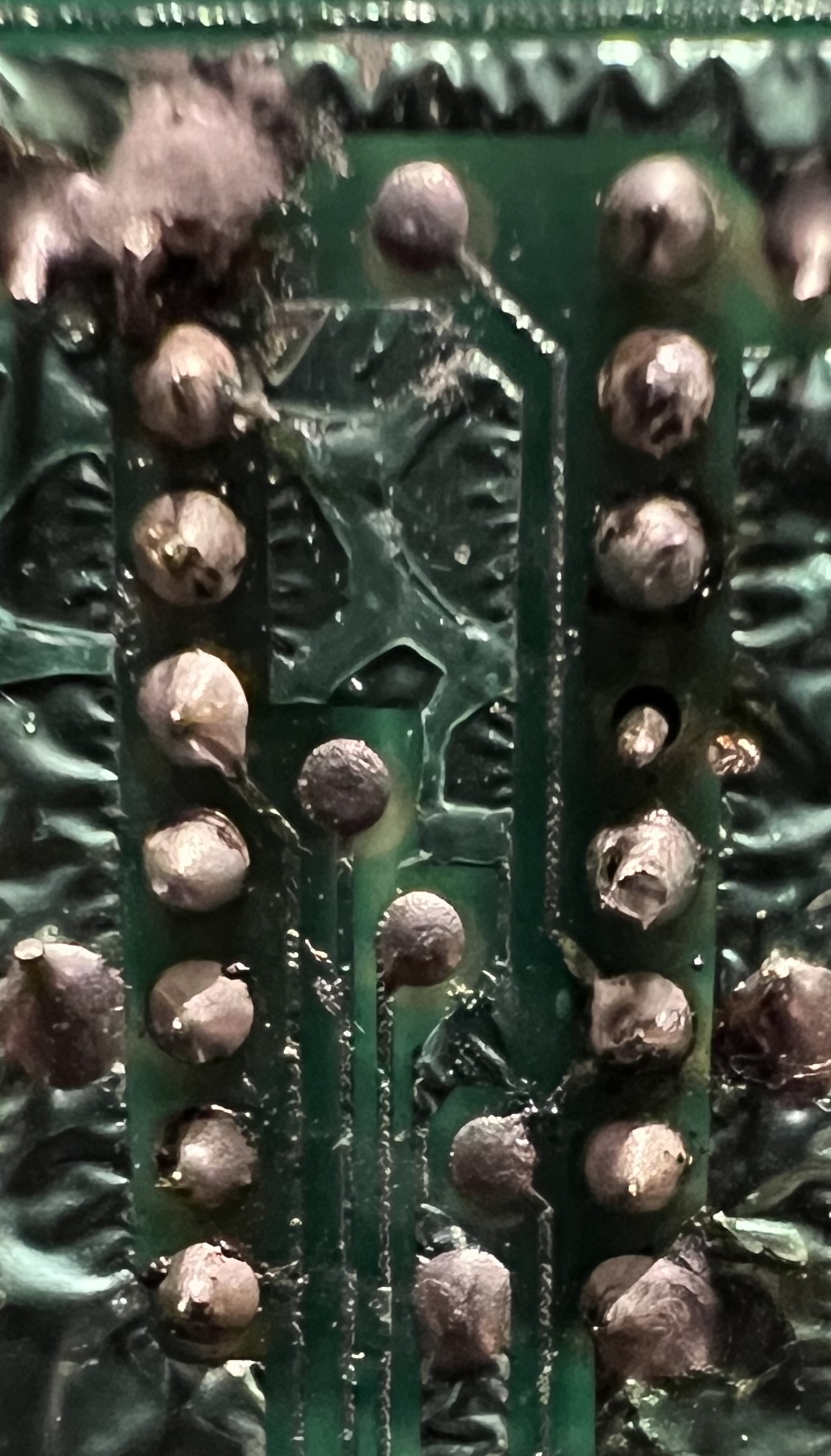

Hi
Send a photo of the damage, usually you can use a thin wire to make a new pad or track. Can be fiddly but worth it, if it works then secure with some epoxy.
Posts: 1042
Re: Piggyback 4164 to Diagnose Memory Fault
Chris_68 wrote: Wed Jan 24, 2024 5:49 pm Hi
The forth leg down on the right has nothing to solder to, but I don't know if there was a track there previously or I've just stripped a ring from the board. I've made a right mess of the whole thing though really

I can take a photo for you, its pin 4 right? If so it should be connected, test with multimeter if its connected to IC 10 and same pin. Could be that the tracks are on top layer.
Posts: 1042
Chris_68 wrote: Wed Jan 24, 2024 7:04 pm Hi,
The top of the image is the edge of the mobo, so I think bottom left is pin 1?
Chris_68
Posts: 126
Post by Chris_68 »
Yes pin 1.
I had a look and it is connected on top layer, I would clean it up a bit and reflow using flux.
Measure so you have connection to IC12 pin 13 ( and the others)
Posts: 1042
Chris_68 wrote: Wed Jan 24, 2024 7:33 pm Hi,
Yes pin 1.
Just checked and I have continuity across pin 13 to IC12 & other chips

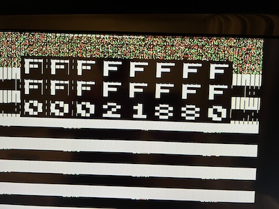

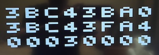

Well I went from this error message, and booting ok
Now I have this and it hangs
Scrap box?
Posts: 1042
t0nyt wrote: Thu Jan 25, 2024 10:59 am Well I went from this error message, and booting ok
Scrap box?
I ran those numbers thru ramfail_bas, out of interest, and it crashes with a bad parameter
Posts: 1042
t0nyt wrote: Thu Jan 25, 2024 11:14 am
Scrap box?
I ran the address thru ramfail_bas again, but this time using the write/read values from the first message rather than FFFFFFFF for both, and it reports IC3 which is directly above IC11 so will take another look at the circuit board to see if I can see where I might of gone wrong
