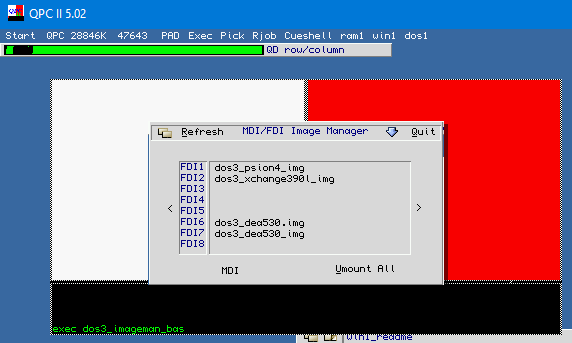

For anyone who's interested. I've finally got my EasyPtr program working.
It may still be a bit rough around the edges. And I'm not happy with OUTLN. If I switch out of the program, alter the screen, then switch back. The screen gets restored.
You need menu_rext, and at least one of the mdi/fdi drivers installed (LRESPR them). Then EXEC the imageman_bas program, with imageman_cde in the same directory.
I have included the two EasyMenu _men files, if anyone wants to play with them.
I did try compiling the program. But it gets upset if the mdi and fdi drivers are not pre installed. The BASIC program checks for their existence and configures itself accordingly.
