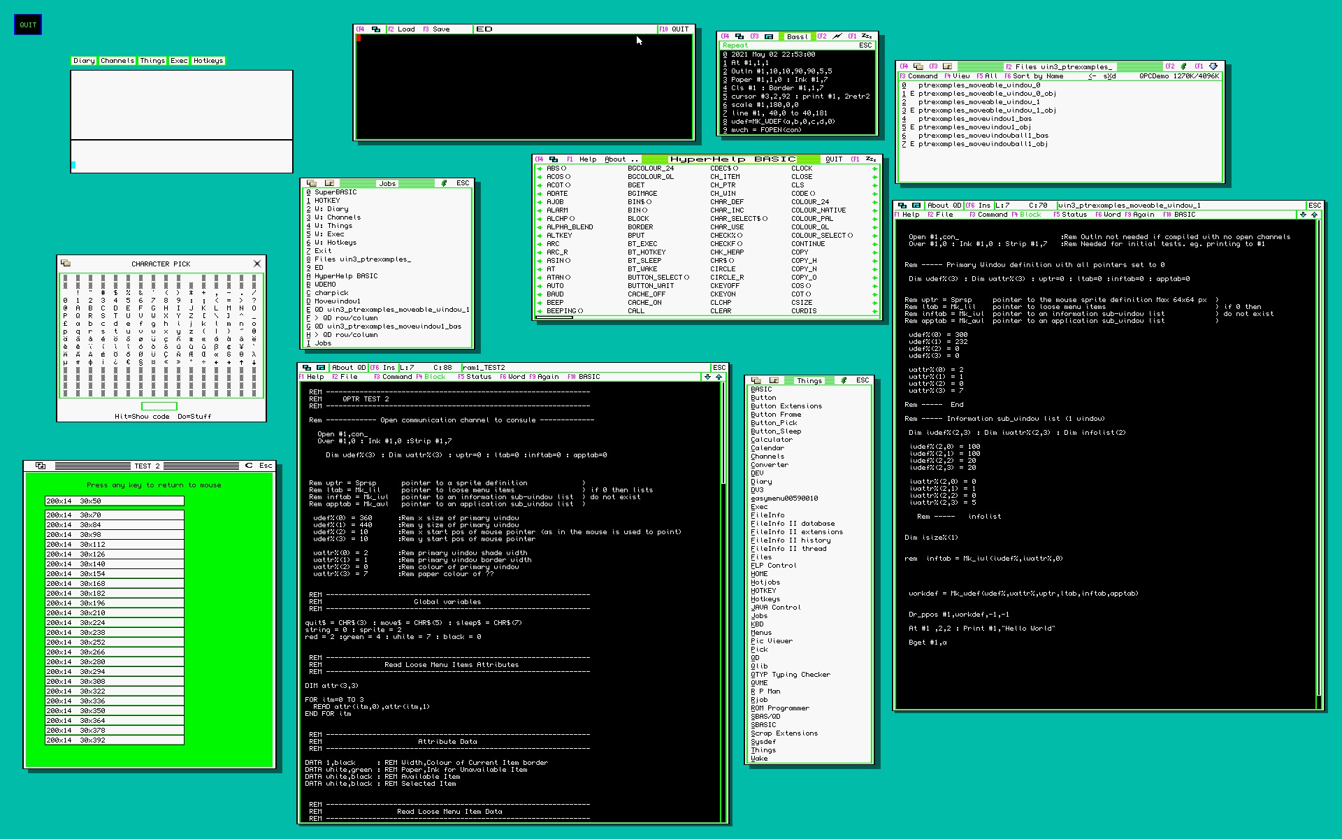

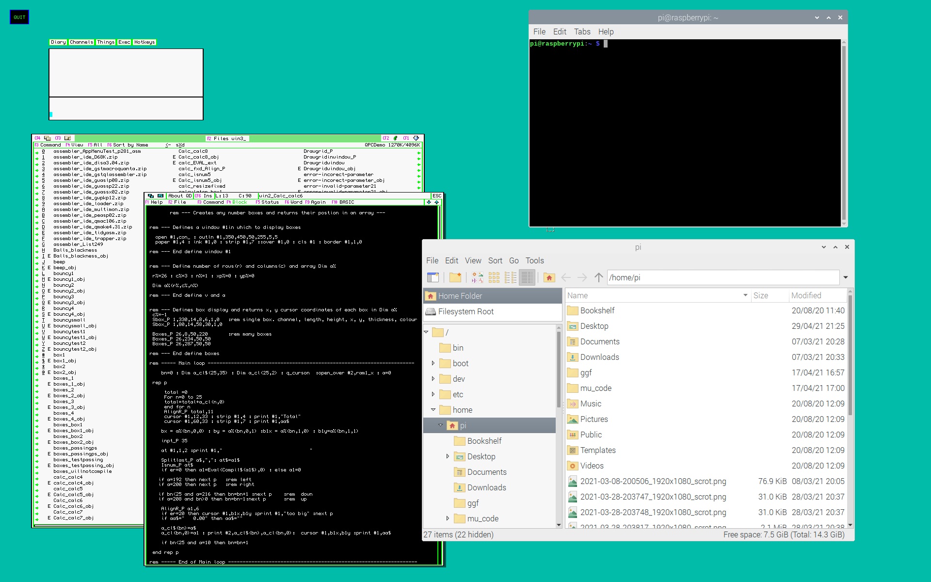

I decided to treat myself to a new 1920 x 1200 monitor. It was on special offer and I had not bought monitor for a very long time.
One of the reasons for buying it was to see how SMSQE performed on a PI 400 at high resolutions. I see that Derek Stewart felt that
the PI is a bit slow. SMSQE on PI 400 is not as fast as on a PC but it is fast enough for me.
I used the OS that came with the PI and am now slightly more familiar with it, and its inbuilt programming environment. I find SMSQE
significantly more enjoyable to use than Raspberry PI OS although the PI connected to my TV is a much better media device than my
existing set-top-box
I have attached two screen shots of SMSQE at 1920 x 1200 on my PI 400 and I would like thank Norman and Sparrowhawk for their advice
on how to get SMSQE running on a PI.

That looks amazing! Good to hear you got sorted running SMSQ on your Pi 400.
Have fun.
