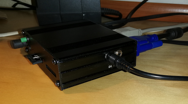

Finally, my Q68 already has QL NET installed by Derek Stewart.
Derek has performed a very professional installation, the connectors are firmly installed and very discreetly on the Q68 right side.
I have been testing and I am surprised at the reliability and robustness of QL Net in Q68. Everything works perfectly. I can now share resources between my Q68, QL+SuperGoldCard+QLSD and QPC2. (Q68 and QL are connected via QL NET, Q68 and QPC are connected via SERNET).
It is very exciting to see how we can access to resources in PC from our QL. (The magic is in the Q68/QPC2 combination, SERNET and QL NET).
Congratulations to Martyn for the driver, to Peter for that wonderful design of Q68 and many thanks to Derek for the installation and support.
