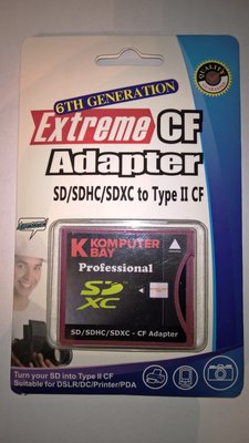

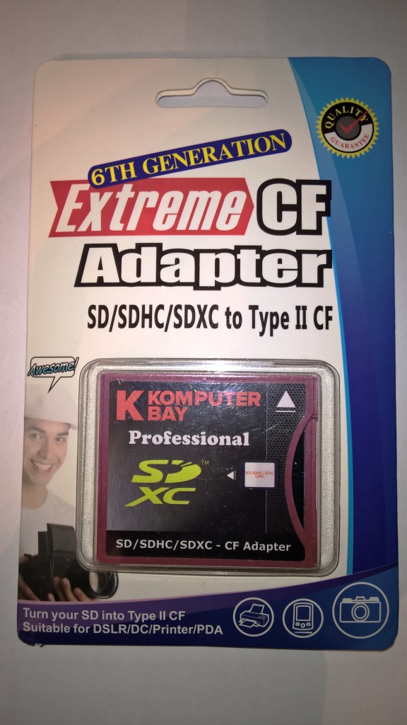

Just a short info about TDI which can be useful for someone's.
As you may know, using SD card memories (with CF to SD adaptor) doesn't work on the Tetroid interface.
This is probably due to a voltage issue. CF cards may generally work with 3.5 to 5 volts range while almost of SD and micro SD work with 3.3 volts only.
Some IDE to CF adaptors has a switch/jumper allowing to select 5V or 3.3volts. Tetroid doesn't and delivers only very precise 5v on the socket.
One day I had a thought. MicroDrive devices with CF type II socket work exclusivelly with 5v. So, If we find a CF type II to SD adaptor, there is a chance that manufacturer had made something to reduce voltage from 5v. As Tetroid socket can accept either type I or type II CF card, this may work.
I have scanned internet and bought this device from amazon costing 17 Euros :
https://www.amazon.fr/gp/product/B004QY ... UTF8&psc=1
And factually, it worked fine with all SD and micro SD cards I could test on my TDI.
If you try to purchase this device, make sure it is the "type II" not another.
Alain
Posts: 2823
Re: Tetroid interfaces hardware info
Hmmmm. *makes notes*
Good to know! Good to know!
