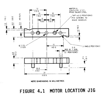

In response to request in a previous post - here's a higher resolution image of the microdrive motor adjustment jig....
Charles
Charles

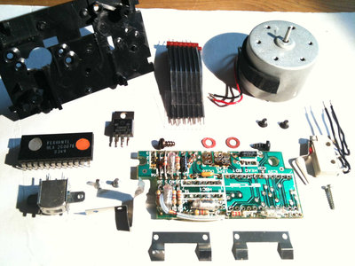

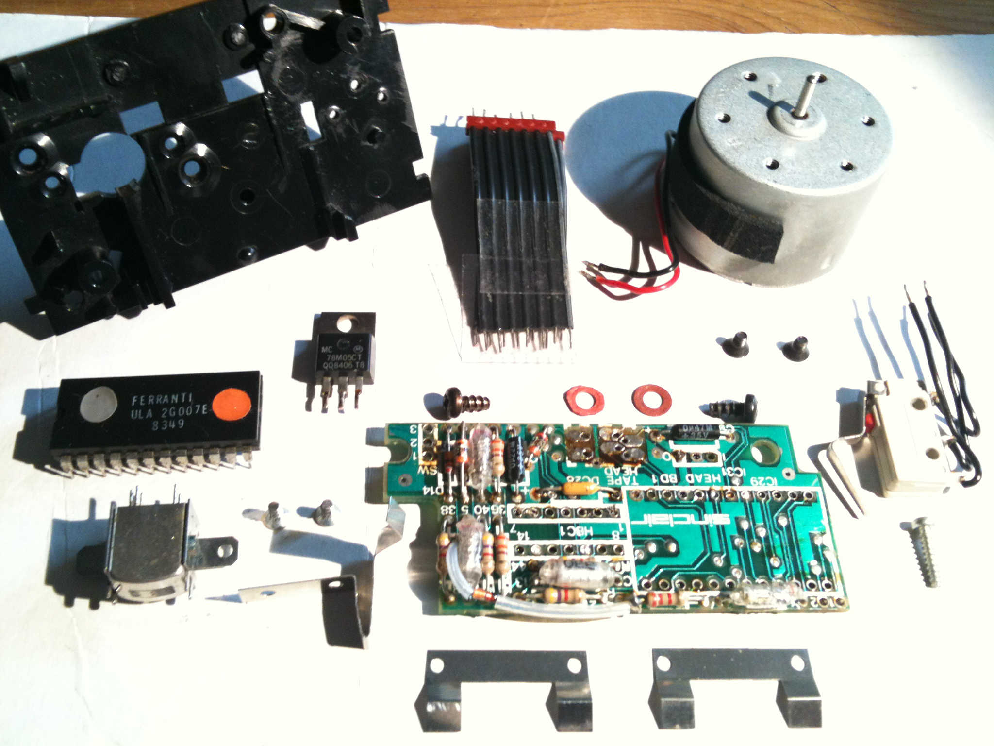

Thanks to All, I am making some progress with MD units. Here is almost complete MD disassembly of an old unit, that was not performing well. All it's components functional providing spares to other units to fix here.
I was surprised to see two `head springs' while I thought only one is needed?
Tomas
Tomas

Hi Tomas,
Looks like you have done alot of work there.
With regards to the Motor Alignment Jig, how does that work, as the QL Service Manual does not indicate how the jig should be used.
The motor seems to secured on the microdrive mounting in countersunk screw locations, fixing the motor positions. Is the jig to locate the position of the motor securing location holes.

Hi Derek,
I am not too confident of my findings yet, just having the idea that `jig' fixes the right angular distance between motor axle and the R/W head face. This dimension is most sensitive to get cartridge white roller properly engaged by the motor rubber roller.
EDIT
I guess precision of some (0.1 .. 0.2 mm), will not be guaranteed just by counter sunk screws, only if there were position fixing `pegs' right on the motor chassis, similar to ones found on the `jig' itself, but that would be more costly. It should be also noted, that motor and jig fixing holes are placed at an angle, possibly for this purpose.
Not sure I am close but I will try to draw an illustrative chart.
Tomas
EDIT

Tomas, this image is simply spectaculartcat wrote: QL-MD_unit_disassembly.JPG

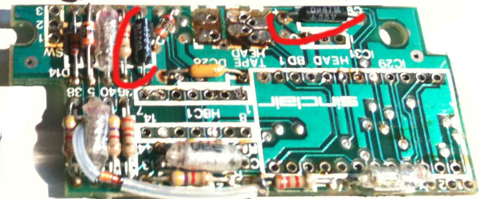

On Microdrive headboard two electrolytic capacitors are found. These seem very solid ITT make, could they dry up in years, if so what values you would recommend for replacement?
The Service Manual gives these values:
C9/C10 - 0.47uF / 35V
C11/C12 - 0.22uF / 35V
They seem smoothing capacitors around 7805 / 5V regulator, but polarity is strangely given as LT-FT, BK-FT. Left-Front? Back-Front?
EDIT 18-Jan'17
Another thought, the cap values are small and seem replaceable with ceramics. I wonder why ceramics was not fitted in prime production, back in the days?
Tomas
EDIT 18-Jan'17
Tomas
Re: Microdrive Motor Adjustment
Labeled like caps or resistors, packaged like diodes, screenprint on one says cap, soooo I'm going to sit on the fence!
