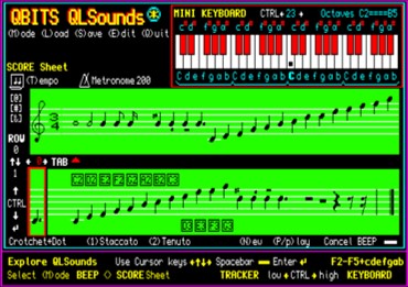

Life has been a bit hectic of late a roller coaster month but some progress on QBITS QLSounds
The pdf updates and code now incorporate the QL Platform Clock TIMER and one or two other changes.
I have also made changes to File Management you can now Edit the whole File Path change Device and add a Sub DIR’s. You are however limited to a max string length of 32 Characters. If you use QBITSConfig the Device can be changed with Up/Down Cursors. If NOT in their place you can Select and Edit up to 16 Device. Drv$(0)=Dev$ the default with Drv$(1 to 15) ie ‘DrvA_’ to ‘DrvO_’ to Select and Edit
In Score Mode I have added key strokes to access the Mini Keyboard directly F2 to F5 represent the Octaves 2 to 5. Press F2 == F5 will take you to the ‘C’ of each respective Octave, add ‘abcdefg’ takes you to a specific Note. Use Shift F2 == F5 + ‘cdfga’ to Select the #Sharp keys. You can PAN the keyboard with CTRL Left/ Right cursors. The Notes are momentarily sounded. Press Shift + Spacebar to continuously sound the note highlighted by the marker [Spacebar to cancel].
QBITS

For self amusement I used the QBITS QLFont editor to create some musical notes. QLNotes_fnt header set to 127,64 so it installs in the extended or upper range the QL Font set. Took about five to ten minutes to get the basic note then using the copy, vertical flip of QLFont Editor took another 30-40 minutes to produce the rest.
Nbase=ALCHP(588):LBYTES device_QLNotes_fnt,Nbase: CHAR_USE#ch,0,Nbase [Device ie ‘win1’]
