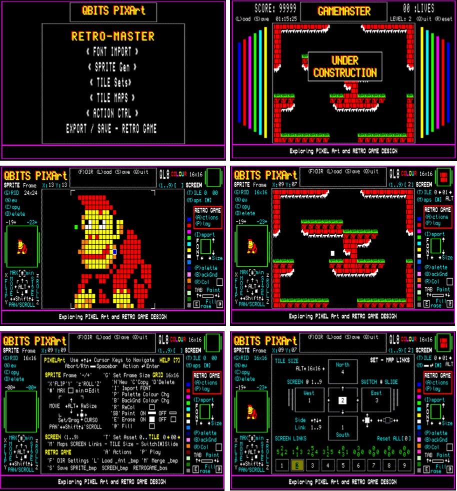

QBITS PIXArt is memory hungry because of the present format of the bitmaps. The development has been with QPC2 Emulator and SMSQ/e. I have it working with a min 3MB with QPC2. Future compatibility with other QL Platforms is on my to do list.
I might be wrong but recall JS ROMs have a max of access to 896KB memory.

I played a bit with your program and it is really nice and packed with features. It took me some time to draw a sprite, as the interface is cluttered and for a while I was lost, but I got the hang of it.
It seems that it needs a minimum resolution of 512x384 pixels to start. Looking at the picture from page 59 it might need more than that (your doc starts with page 58, so 59 is the second page)
What's the best resolution to run the program?
ALT commands do not work on my Windows PC. (ALT and arrows rotate the Windows display
The BMP file saved is not really a bmp format file, so the extension is misleading.
Next I will try to create a Tile map.
Maybe you can upload some sprites and tile maps for us to play with.
