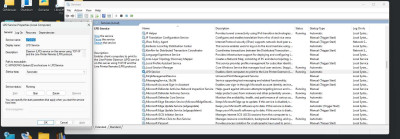

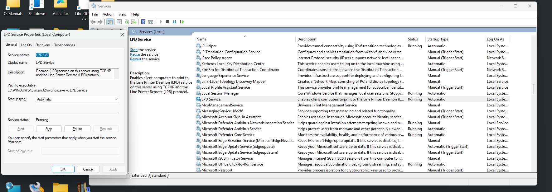

The LPD Service says it's set up and active in Windows 11 Home after following instructions. services.msc now says it's running.

LPD
LPD
