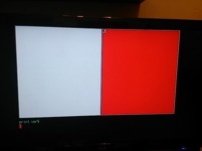

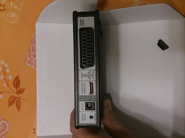

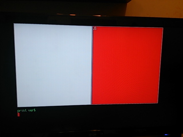

As promise I'll post some images from different scart-to-hdmi scaler buyed on amazon; it works fine with my LG LCD tv but doesn't work with a new LG smart tv :o

belg4rion67 wrote:As promise I'll post some images from different scart-to-hdmi scaler buyed on amazon; it works fine with my LG LCD tv but doesn't work with a new LG smart tv :o
Thank you for the pictures. It looks pretty good. The screen dump shows you don't lose a couple of characters off the edges of the screen like a simple QL to SCART connection often does.
Shame it wouldn't work with the SMART TV. Maybe there's a good reason that just hasn't been found yet?
