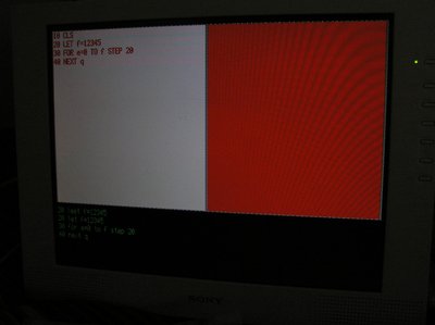

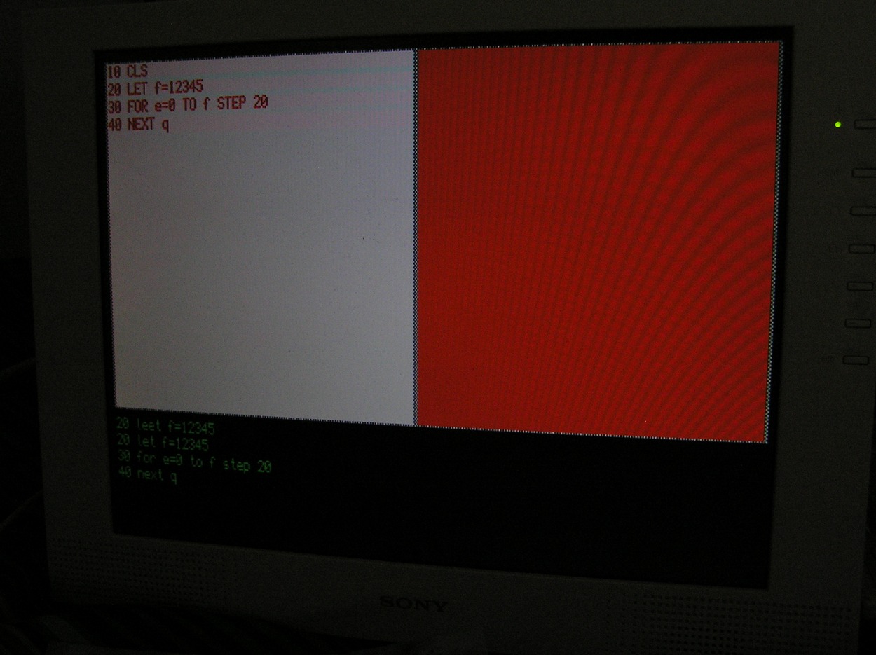

I just wonder all the time, why nobody complains about the lack of flatscreen monitor support for the QL. Storage is obviously important, but I have no idea how to achieve a decent 512x256 QL display nowadays. Do you all press F2 and use TV mode? Or do you all still own working CRT monitors?

I use an RGB2VGA board GBS-8220 :)

GBS here as well. Through an Extron unit.

I have that too, but isn't it a pain? Characters are hardly legible in 512x256, and single pixels (e.g. at the border) can not be distinguished. Do you use it in 256x256 only?

I have a photo for you, luckily. You can check the quality of the image yourself.
Please note that it looks a lot more fuzzy in the picture, firstly because it's a low-light photo, which means long-ish exposure time and thus, some movement and secondly because it's been resized to a lower resolution, to fit the 256k limit.
