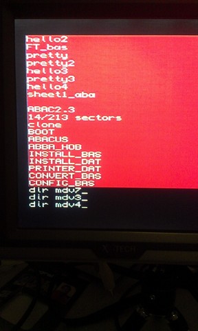

Did some serious ARM assembler coding tonight ;)
Translated the cumbersome get_bit routine to ARM assembler and it now works on the LPC11U24 (the 'light' mbed), reading and writing and now even with multiple microdrive images.
Mounted my test MDV1.MDV image on mdv3, ABACUS on mdv4, ARCHIVE on mdv5, EASEL on mdv6 and QUILL on mdv7
load mdv4_boot
edited line 8 to point to mdv4
save mdv4_boot
run
ABACUS starts
typed in some stuff in some cells
saved the sheet to mdv3_sheet1
restarted the QL and ABACUS and read back the sheet...
It is not as fast as a floppy (not yet at least) but it works!

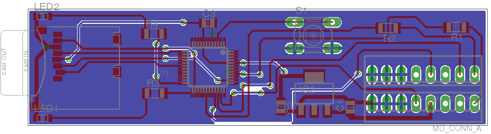

Playing with Eagle resulted in this design:
preliminary md board
This board is to be put directly onto the MD connector and the microsd card will sit vertically at the righthand side underneath the edge of the QL.
There are some things to add like JTAG or such, but firmware updates should be doable by uSDcard later on.
