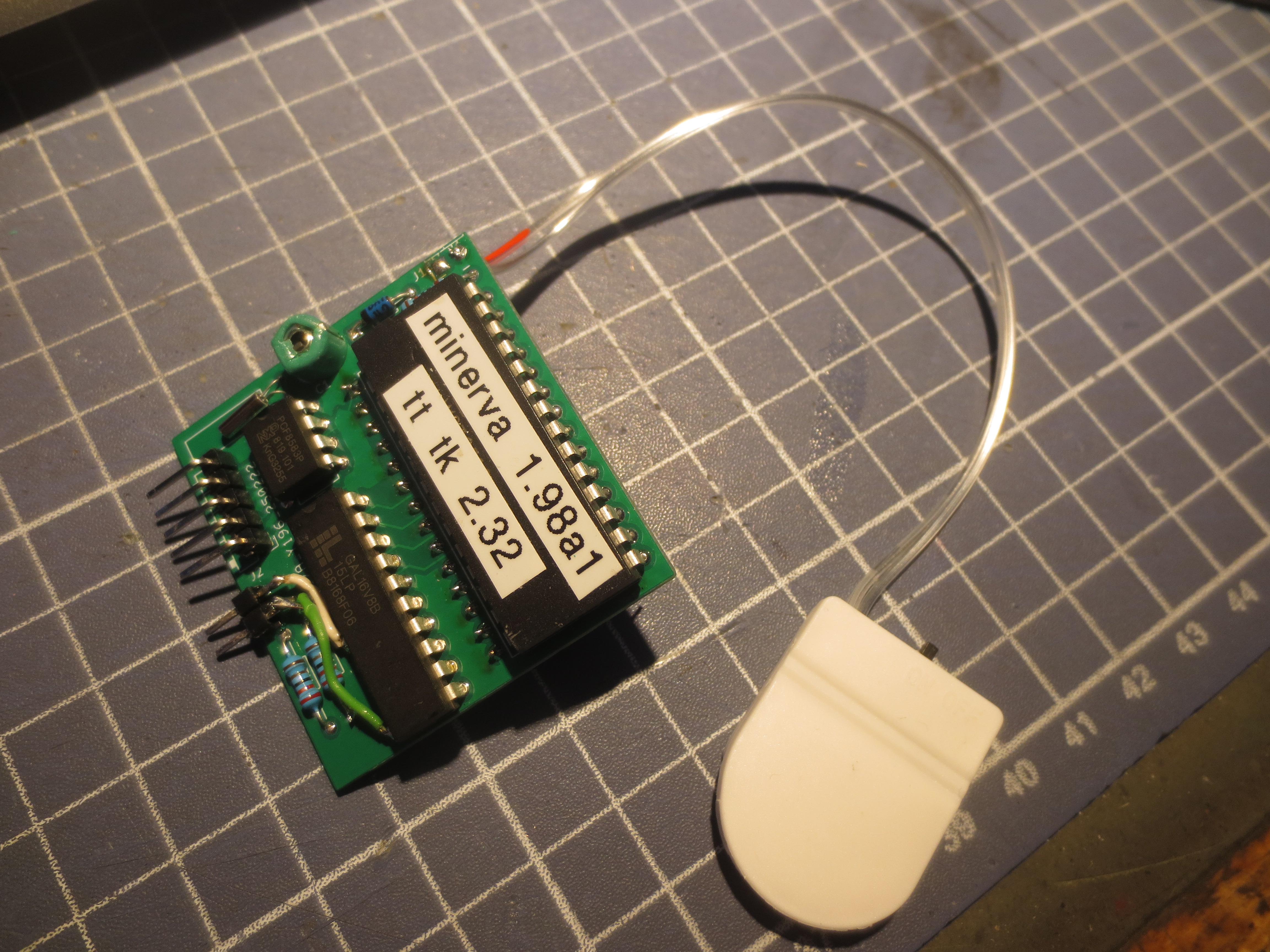

T48 , software 12.90 released including new firmware
btw assembled mkII should look like this ;

techy wrote: Fri May 09, 2025 8:28 am btw assembled mkII should look like this ;
Nice!
My first attempt won't look quite like that as I'll be using sockets (as it doesn't need to fit inside the QL and means I can easily extract IC's for troubleshooting) and I'm skipping the upper 16kb to keep it as simple as possible for now so no jumper for that
That all assumes I can put it all together in the first place!

techy wrote: Fri May 09, 2025 8:28 am T48 , software 12.90 released including new firmware
This board looks very nice job!
Look... now what I would advice considering the image... clean/remove the residual flux.
Use alcohol iso-propyl, teeth brush and kitchen roll.
Spread some alcohol on the PCB where you have flux, put the paper on it and brush it.
Some residual flux (depending on the quality) could produce problems (short story) in short or long term.
Moreover you will be happier with the new look, fresh and clean :) try it please.
No idea about this project size (I cannot appreciate the height by the photo), I guest it is perfectly fine and measured, but would not be a bad idea to be careful with the plate. Your pins thread could make short with the keyboard plate (it is conductive). Moreover if it is manipulated while the QL is powered (typical opening, check something and then closing the case again while it is running). Does make sense?
For extra protection could add some caps on the pins to cover them, like IDC female row and remove them when needs.
One question techy, It seems you soldered 2 IDC pins (jumper on the right) directly to the IC (a GAL I think), Are not the tracks on the PCB? or it was a special mod for convenience?
