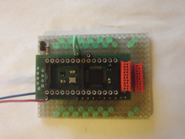

Posts: 2507
Re: QL-SD card project
Hi all,
an update on this project:
I'm working on a test board and a special PLD logic which allows detailed checks of the main QL-SD unit (the "QLROMEXT" board). It semi-automatically tests all the relevant signals and displays the result by LEDs.
The test is performed independently, outside the QL. In case of a fault, the test board determines exactly which signal(s) are affected. It can be used during early production, while it is still relatively easy to correct soldering issues with the fine pitch SMD components used by QL-SD.
Sorry for the delay in releasing the QL-SD driver source code, which is caused by developing this equipment. At the upcoming German SInclair meeting, we will discuss and implement the details of the test process. I hope this tool will help to make QL-SD production more efficient.

Posts: 2816
Those 0.5mm QFP pins are tricky to hand assemble. I imagine once you've put the DIP socket on, it makes it really hard to do rework on it.
Posts: 2507
Yes, therefore the test board can be used even before the DIP Socket is soldered. The object under test is then pressed into lines of conical pins. The oscillator is also tricky to solder - blinking LEDs show that it works. ;)
