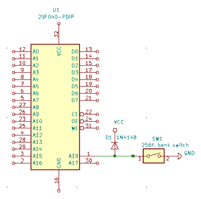

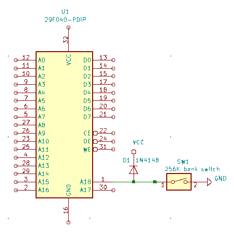

All the SRAM backed protection, makes me thinking about mechanical bank switching on 512K eeprom, as I can address only 256K upper or lower halves. Here I rely that a reverse leakage is big enough to pull address line high, and not that big to be pulled low with a switch. I know resistors could be used instead, but I am interested in a use of a suitable diode? Could this work on power on as well as runtime?
Tomas
Tomas

I strongly recommend you do use a resistor to pull up undriven address line inputs. For CMOS chips, a value of between 4.7kΩ and 10kΩ is suitable.
If an address line for a CMOS SRAM is allowed to float, it will pick up interface and static charge from other conductors or conductive bodies/objects. And it could then ‘see’ a logic low or a logic high or keep flipping between high and low. Then the CPU may well access the wrong memory location(s)...
The reverse leakage current of a silicon diode reverse biased at 5V is tiny and may not be enough to be reliable. And in fact, I see no need for a diode as shown on your schematic. Put a resistor in place of the diode
Mark
Mark
