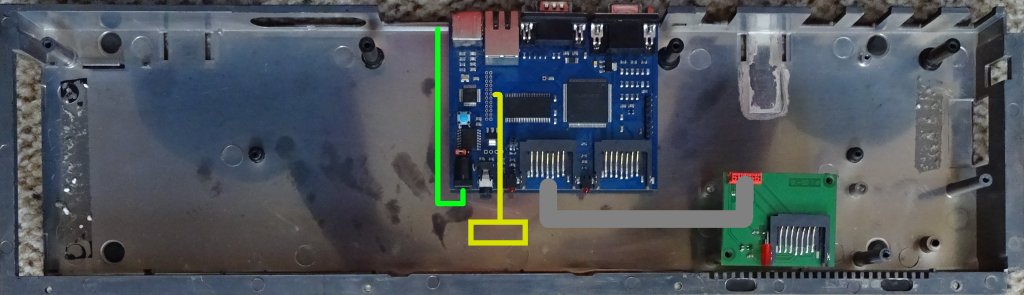

tofro wrote:I'm not so sure the case variants are much of a problem - You could make some laser-cut steel filing stencils for cheap for the new openings and have people modify their cases themselves. The BT plugs are anyhow nearly impossible to find nowadays. But if someone absolutely wants their case left unmodified, so be it.
If ripping out the original mainboard and dumping the microdrives is acceptable, we could even ask: Why not use the Q68 plus a little kit? The non-british case would not require filing for that:
We'd need at least a cable adaptor to the existing card socket portion of QL-SD (grey), and a matrix keyboard adaptor (yellow).
A power lead (green) is not strictly necessary, 5V could also be supplied by a modified PS/2 Y-cable for the mouse.
Even the Aurora, which was targeted as QL mainboard replacement, was not easy to build into a QL. I can imagine the Q68 would be easier than that, if a kit is provided. Most external connectors are easier accessible than Aurora. A cover for the case opening, also fixing the Q68 board, could easily be derived from the Q68 back panel I already designed. If made wider, it could even hold the NET connectors at the original place.
Significant design work would "only" be the keyboard adaptor. In quotation marks, because a 100% compatible solution requires IPC and ULA implemented somewhere. Doable inside FPGA, but work. Even less compatible matrix converter projects did not finish yet. This is where keeping the original mainboard actually saves work.
However, I remain in a lot of doubt about ripping out the original mainboard, after what we just read from a returning QL user.
