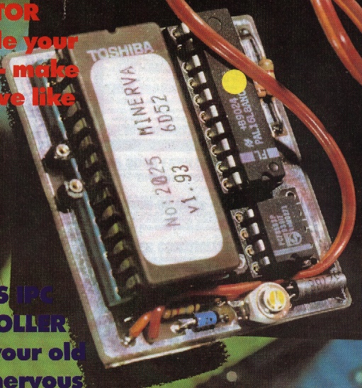

Derek_Stewart wrote:Hi,
I have Minerva MkII that I was repairing broken pins on the Rom Socket.
But I decided to remove the complete Rom Socket and see if I could reverse engineer the PCB. As Tony Firshman sent all his Minerva Stuff into the Texas Black Hole...
Here are photos of the Minerva MkII PCB minus the ROM Socket.
Not sure if that board was tested working but the GAL is the wrong way round unless my eyes deceive me…
One third of the original QView Minerva crew.
Posts: 4854
Re: Still possible to get Minerva ROM
HI Stu,
The GAL does look like it is the wrong way around, I can not remember removing it, but I think this Minerva MKII was something I was given, maybe the GAL fitted incorrectly makes the Minerva MKII not functional and the the whole thing is faulty.
I will remove the GAL and see if it is working OK.

QViewStu wrote:Not sure if that board was tested working but the GAL is the wrong way round unless my eyes deceive me…
David
That looks like a stunt Minerva without the legs bent out to fit the PCB socket ;-0
