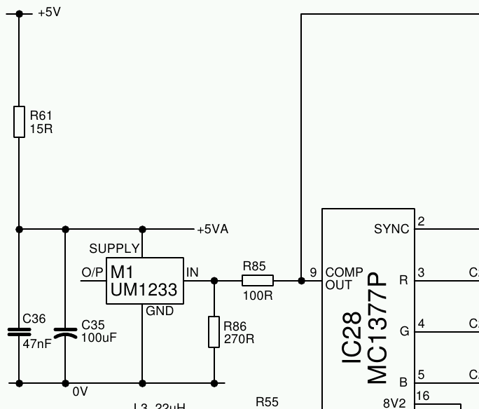

Try lowering the composite output amplitude before the input of the modulator, or providing better power decoupling - which is a problem for many parts of the QL motherboard.

Now again studying `QL Service Manual' and Issue#6 diagram. It says composite PAL signal is output/divided to UHF Modulator, capturing in the picture, when you say lowering amplitude, you mean changing values of the resistors R85/R86, how?
- Composite PAL feed to UHF modulator
Could it also be some of the modulators' transistors being degraded, worth replacing?
Many thanks so far.
