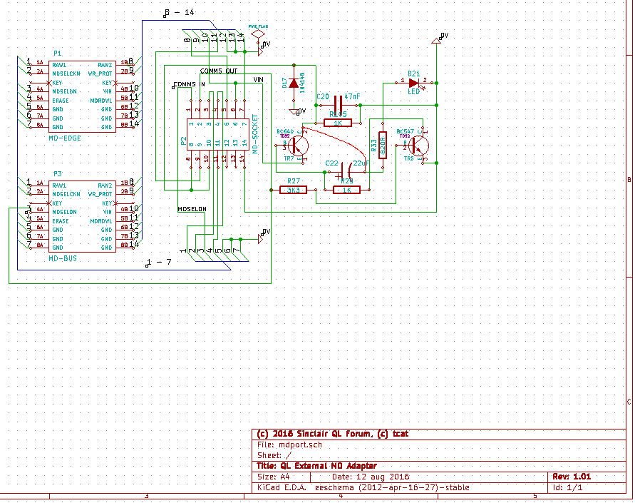

Meanwhile I have completed the adapter schematics.
MD PORT
MD PORT
Remaining questions>>
EC1 edge connector numbering 1A-8A is TOP, 1B-8B is BACK, or vice versa?
Substituting ZTX551 for BC640, and BC184 for BC547B, I hope it is alright?
Many thanks so far.
Tomas

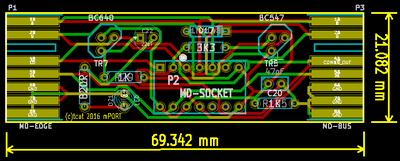

Provisional board design, as I am not much into electronics, this is my second ever design in KiCad, next to Simple RAM.
I struggle a little with transistors, there seem variants PNP, NPN, having different voltages, currents and gains, they also differ in pinouts BCE, EBC etc.
So I hope I picked suitable substituting types to the original QL design.
MD PORT, mPORT board design
P.S. I used components reference as per HEAD BOARD 2, so can be checked against
Tomas
Silvester
Posts: 436
Re: QL's external MDV port
Post by Silvester »
tcat wrote:
I just flip off the small black cover over the adjustment hole, at the bottom of motor corpus to get reach to the potentiometer.
Just push small screwdriver through existing hole. There is a rubber membrane in base of motor which has already been punctured to allow factory set up.
The MDV connector on right hand side of QL is, looking into PCB slot:
8A 7A 6A 5A 4A | 2A 1A
8B 7B 6B 5B 4B | 2B 1B
(verified on unpopulated issue 6 QL PCB. Also, unused WR PROT pin 2B has no track connection)
There is a missing link on your diagram (shown in red), it would work but the LED would not light. Everything else checks out. (Have to look up transistor data, haven't got it to hand.)
I would be very careful checking you wiring - the ZX8302 ULA is very easy to damage with momentary short-circuit. I did so once when putting a probe on COMCTL (pin 29) to monitor IPC link.

tcat
Posts: 633
Post by tcat »
Hi Silvester,
Thank you for checking my circuit diagram, I will add the missing link, and redo the routing.
I am also glad for your EC1 pinout confirmation, I had measured 9V voltage between VIN (4B) and GND (8A 7A 6A 8B 7B 6B), so I was almost certain then.
As for transistors I picked these types based on their specs.
Original QL specs:
TR6 / TR7 :
ZTX551 / Zetex Semiconductors
PNP 60V/ 1,0A/ 1,0W TO92 C B E
hfe 50..150
TR4 / TR5 :
BC184 / Fairchild Semiconductors
NPN 30V/ 100mA/ 350mW T092 C B E
hfe 100..130
Found close specs:
TR6 / TR7 :
BC640-BLK / Fairchild
PNP 80V/ 1,0A/ 0,80W TO92 B C E 7c
hfe 40..160
TR4 / TR5 :
BC547"A"-BLK / Diotec
NPN 45V/ 0,10A/ 0,50W TO92 E B C 7a
hfe 90..120
Please NOTE
There are other variants "B","C", but "A" has closer hfe gain to the original.
Tomas
1024MAK
Posts: 593
Post by 1024MAK »
tcat wrote:As for transistors I picked these types based on their specs.
Original QL specs:
TR6 / TR7 :
hfe 50..150
TR4 / TR5 :
hfe 100..130
Found close specs:
TR6 / TR7 :
hfe 40..160
TR4 / TR5 :
hfe 90..120
Please NOTE
Hi Tomas
Both transistors are just being used as switches, so selecting replacements is not particularly critical.
For TR4 / TR5, any small signal NPN type that has a gain greater than 90 should be okay. A higher gain figure does not matter. So a BC547B or BC547C or indeed BC548, or BC549 plus many others should all work okay.
With TR6 / TR7, they are being used to switch the motor current. So the requirement here is the current rating. So we need a transistor rated at 1A at least (a higher rating does not matter). The gain should be 30 or more (again, a higher figure does not matter). The power rating should be 0.5W (500mW) or greater.
Note that the overall gain (multiply the gain of the two transistors together) should be greater than 2538 (so for example 90 x 30 = 2700). And in fact, in the design process, engineers prefer to have a large margin because real word transistor gain varies with temperature and operating current.
As this is a 9V nominal system, the transistors voltage ratings don't really matter, as very few discrete transistors have low voltage ratings.
Mark
