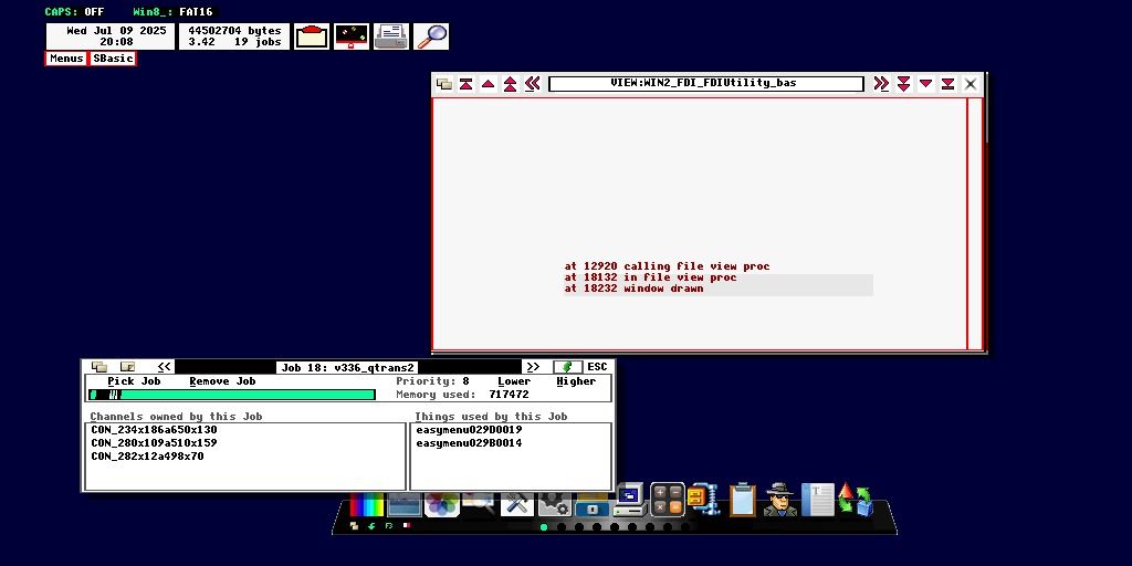

I have attached the screen shot for QTrans debug2. As you can see the last report before it hangs is at line 18232.
The jobs menu shows that the channel to be opened at line 18240 has not been opened.
Could the Q_ERR_ ON keyword cause the qtrans to hang. If so it may explain why Q604F runtimes work for most programs as some/many
won't use the Qliberator error trapping key words.

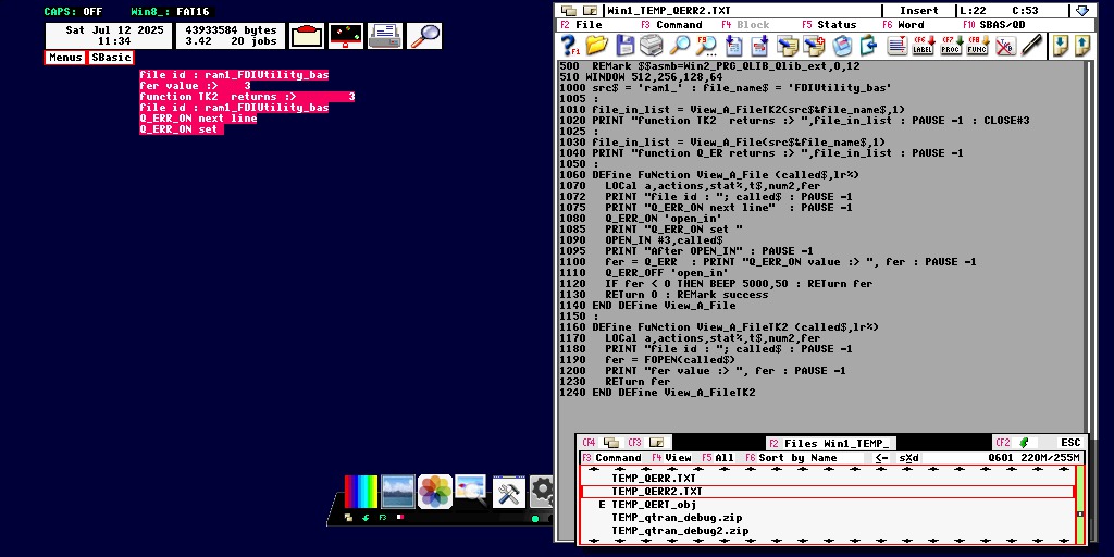

I have tweaked and compiled the snippet of code Dilwyn Jones supplied. The image shows the code and the outcome indicating that the program
hangs after Q_ERR_ON was set and when error trapping OPEN_IN.
