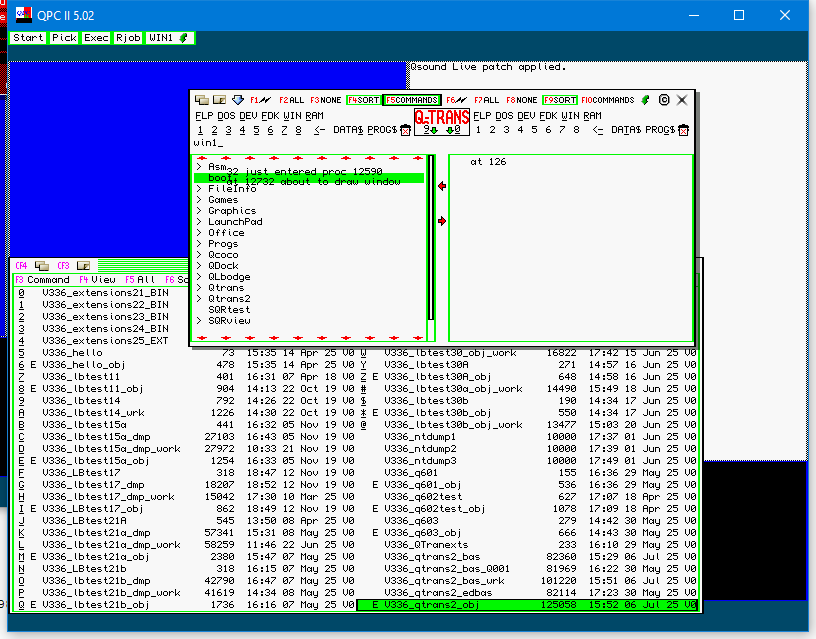

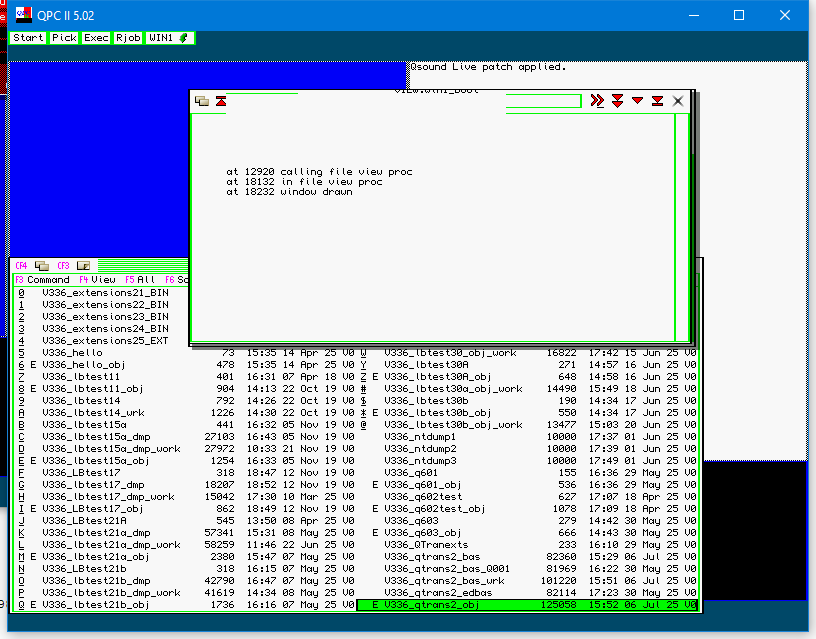

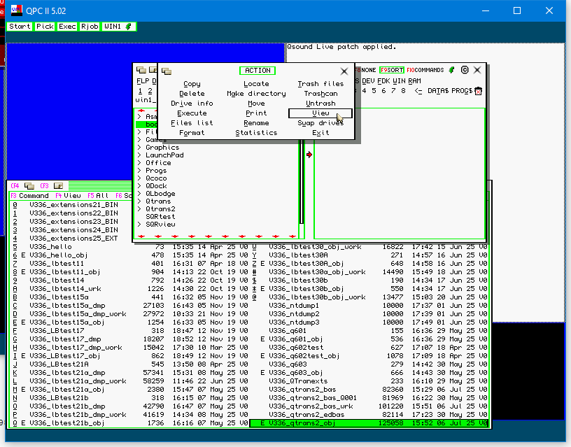

Hello Martin,
I have screen shotted debug Qtrans. There are 3 .jpgs in the zip file.
Image 1 is debug_qtrans "raw" showing where it hangs while trying to display a text file in it's internal viewer.
Images 2 & 3 are debug_qtrans QEXECed showing that when helped by QEXEC it can pass through the point at which when "raw" it hangs
and display the same file as in image 1.
I look forward to hearing your findings from the code.

If I can find some time tomorrow, I will see if I can narrow it down further with another debug program.
So everything looks OK until after line 18232, and before line 18362
Is QEXEC Wolfgang's 'turn off the cache' program?
