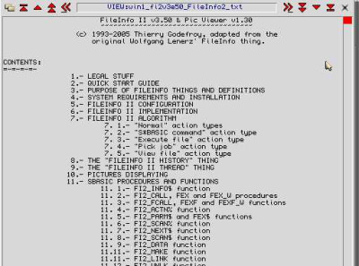

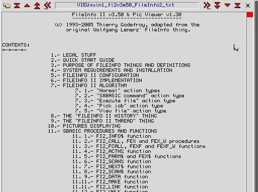

Depends which version of FilInfo2 you're using - Older versions have FEXF , more recent versions have FI2_CALL
Because of the different keywords in different versions I had to do the check on which keyword existed, in order to use the recommended keyword for the version concerned. Documentation for v3.50 states: "The FEX procedure (and FEXF function) is the exact equivalent of FI2_CALL... FEX and FEX_W are kept for upward compatibility with older FileInfo things only; these procedures should not be used any more in modern programs as their name clashes with SMSQ/E v3+ built in procs. By default FI2 v3.50+ is configured so to skip the initialisation of the FEX and FEX_W procs... and of the FEXF and FEXF_W functions"
FileInfo2 keywords
FileInfo2 keywords

FEW, FEX are SMSQ/E v3+ keywords and there are also FEXP (Lightning math) & FEXP$ (TK2,Minerva).
FEX, FEX$, FEX_W; FEXF, FEXF_W are (old) FI2 keywords, and now replaced by FI2_CALL to avoid conflicts with SMSQ/E .https://www.wlenerz.com/smsqe/addkeys.html#FFF
The old keywords are switched off by default in FI2 but if a program expects the old ones they can be switched on again.
One of these programs is DiskMate5. To use that I edited all FEX names in both DM5 and FI2 to FFX and made them active in FI2, next to the FI2_CALL function for those that expect it.
