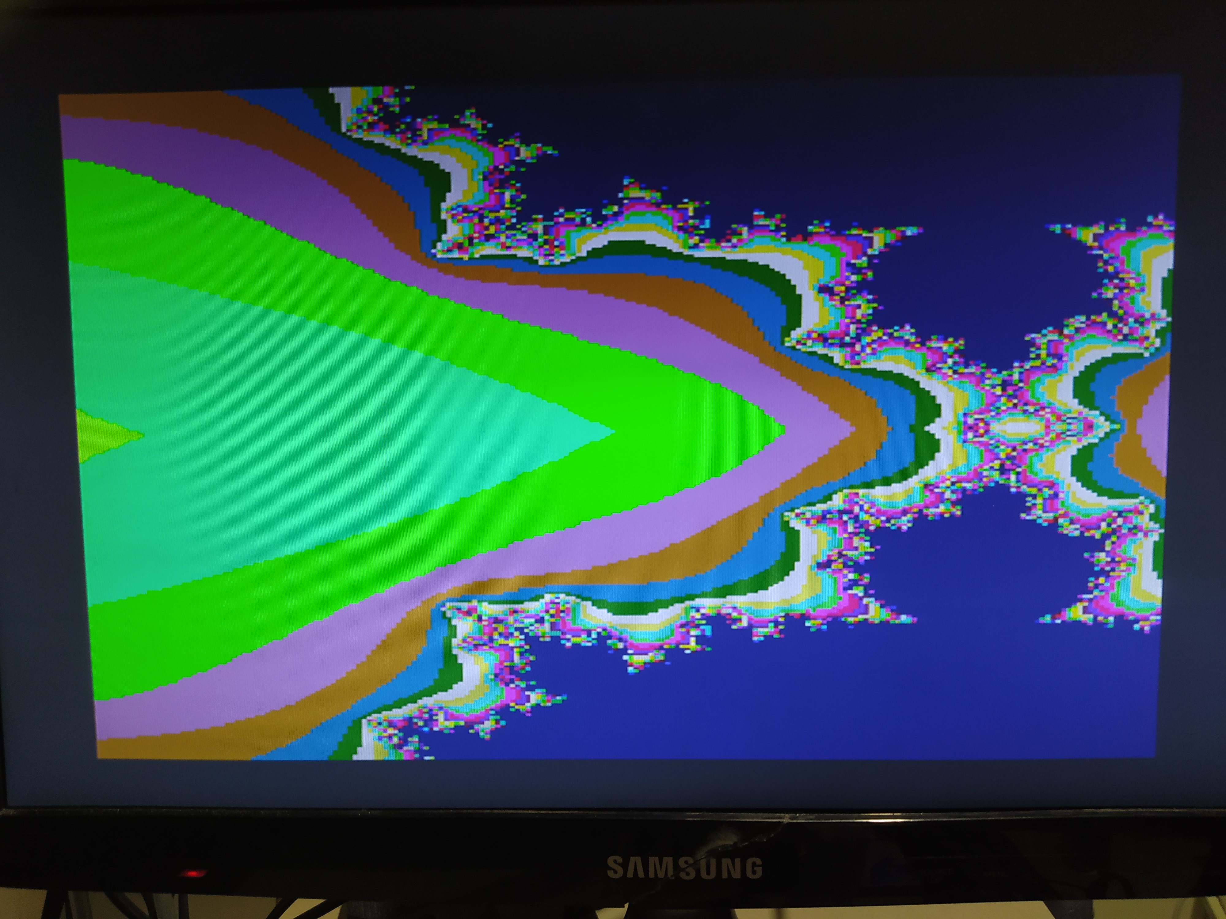

yes I use 16K of ram for one or two bits more color
new plot command for the 64 colors:

thanks,
The extra ram is inside the fpga (as is the sprite ram) and so it can be accessed in parallel with the other video ram without any extra delay.
I believe that all the address space I used for new features can be reclaimed and be available to external cards with the standard pull hi the DSMC method, I tested this with the 2MB onboard ram and the qubide clone with its own ram that works perfectly.
