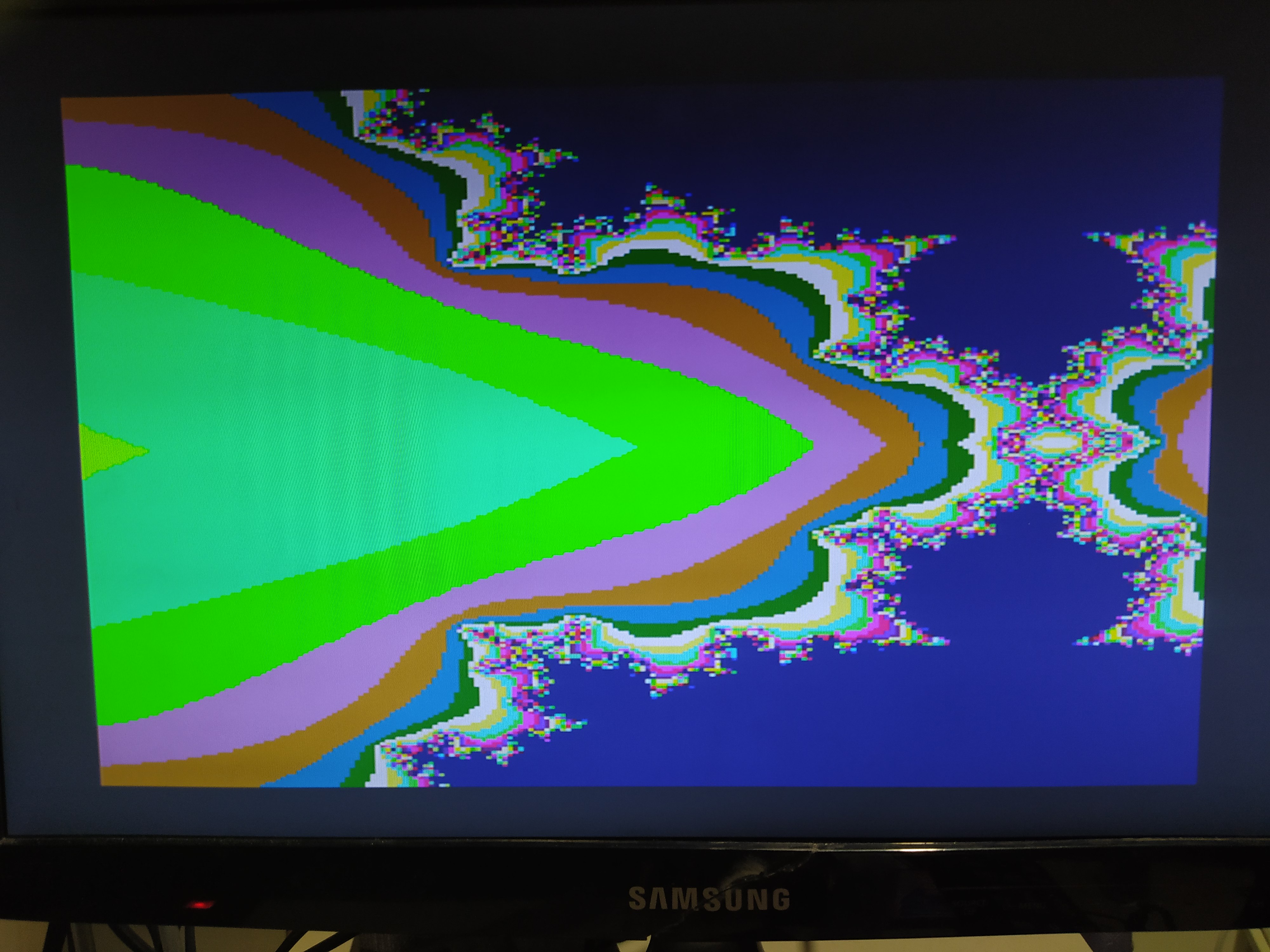

yes I use 16K of ram for one or two bits more color
new plot command for the 64 colors:

Impressive, great job!

thanks,
The extra ram is inside the fpga (as is the sprite ram) and so it can be accessed in parallel with the other video ram without any extra delay.
I believe that all the address space I used for new features can be reclaimed and be available to external cards with the standard pull hi the DSMC method, I tested this with the 2MB onboard ram and the qubide clone with its own ram that works perfectly.
