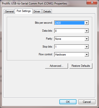

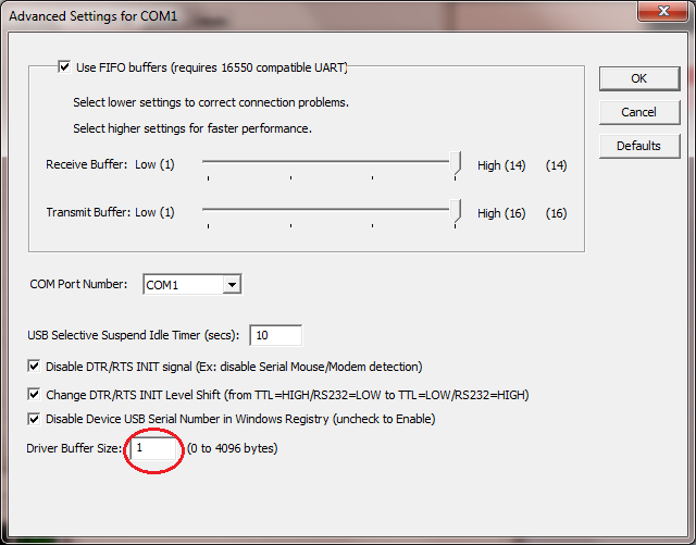

So I got it to work, sort of. Basically, even with hardware flow control it loses characters. If you set it to 300 bauds it works pretty well. That should be fine for testing purposes.
Below are the settings of my generic USB-2-Serial converter. The key seems to be setting the buffer to 1 byte. If I have at at 2 or bigger, it starts substituting characters, i.e. at 1 byte if I type "a" and "t" it accepts it as "at", but at 2 bytes or higher if I type "a" and "t" it sees it as "ad" -- and many other characters are substituted as well, like for "ate1" it sees "adeA" so it gets some characters correct and some wrong.

bwinkel67 wrote: Fri Aug 15, 2025 9:50 am Below are the settings of my generic USB-2-Serial converter. The key seems to be setting the buffer to 1 byte. If I have at at 2 or bigger, it starts substituting characters, i.e. at 1 byte if I type "a" and "t" it accepts it as "at", but at 2 bytes or higher if I type "a" and "t" it sees it as "ad" -- and many other characters are substituted as well, like for "ate1" it sees "adeA" so it gets some characters correct and some wrong.
Does it have an option to use the software settings (through the standard COM calls) instead of overriding them?
EDIT: never mind, I found many drivers have similar UI. They should still respond to software changes (e.g. BAUD command on QL side), although I've seen some of them not liking those calls.
Posts: 1604
Re: SlipKnot-like Browser for QL - Mimir
M68008 wrote: Fri Aug 15, 2025 6:12 pm Does it have an option to use the software settings (through the standard COM calls) instead of overriding them?
Yup, it does change settings with software commands on the QL side. For instance, I can set the BAUD rate on both the modem (via atb300) and then the baud rate of the port via a software call to match up. The configuration on the COM port is only the initial setting.
[Edit: I think if you look at varies USB-2-Serial converters they would have the same UI because it comes from Windows and not the manufacturer (i.e. there was no software disk that came mine). One oddity, that might be tripping you up is that I'm doing this on my hobby laptop which I run Windows 7 on and not 10/11. Not sure if the UI has been updated on the latest version of Windows, but there is no reason to suspect the older Windows would be flawed since we are talking about old technology.]
