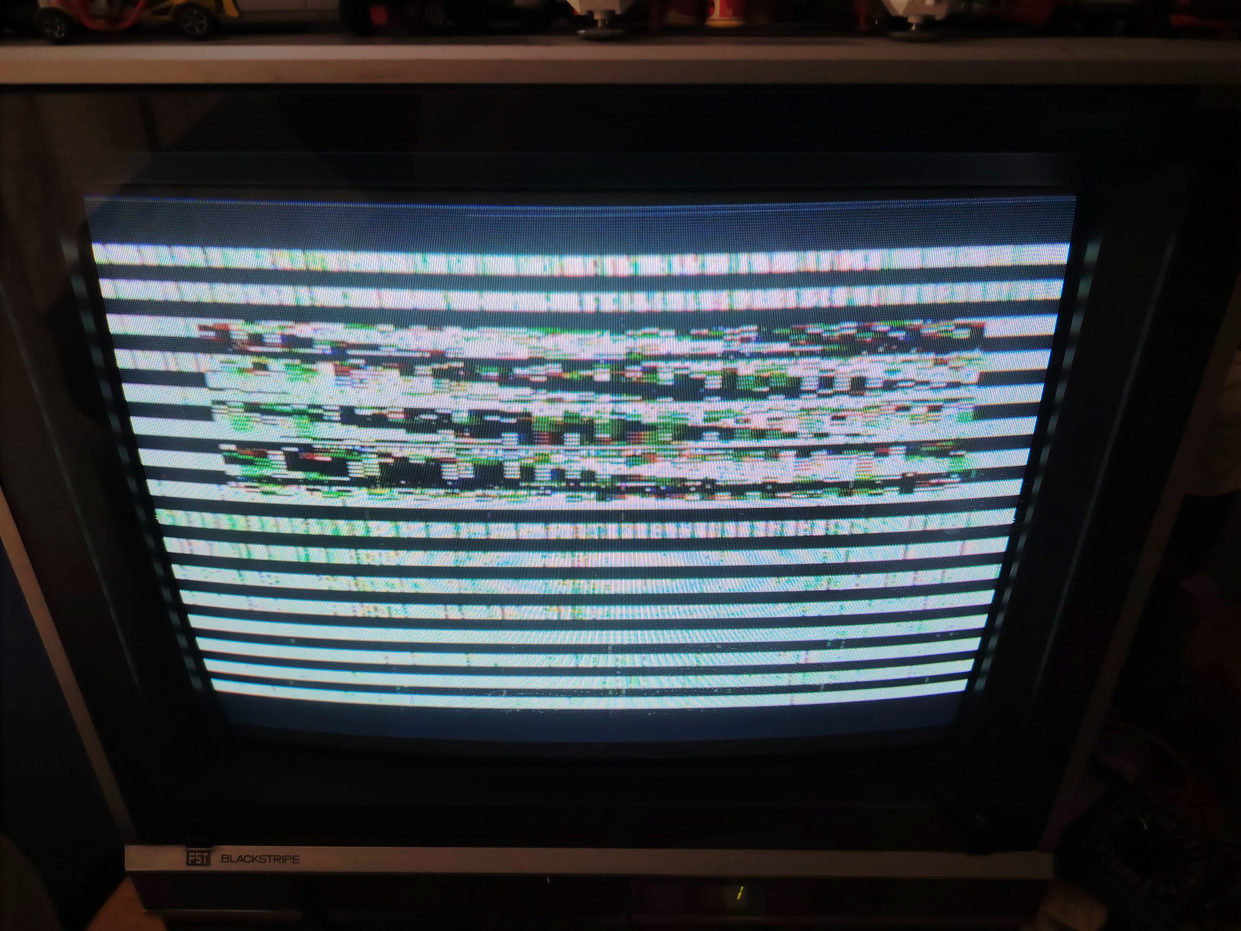

Hi
It's funny I am in the process of trying the ram with minerva now
I am getting this screen which looks like it is trying to give a ram error but can't.

Posts: 1626
Re: Sinclair ql black screen
I remember seeing output like that with Aurora card and qubide where my qubide card had a bridge between 2 address lines, causing a short on the bus. The regular repeating black lines are a giveaway. I would check the adjacent address lines and see if you have a solder bridge somewhere, could be a speck, a component lead - it may not be big. A multimeter on continuity check when the QL is powered off will be useful to check address lines - if you've resoldered any sockets / chips - check them first.

I have tried the heat test on the ram none getting hot and found one spare 4164 ram chip I have I tried piggybacking each ram chip but made no difference.

Can you burn an EPROM? If so put my diag ROM (see separate thread) on one and use the Minerva ROM adapter with it. You should get some useful information about which RAM chip(s) may be an issue, or if everything's bad, one of the support chips.

The test in piggyback is not a final word :) you may have more than 1, or (even if you didn't detect it ) one of those RAM IC has shorts between ADDR lines.
The Stephen ROM is a good way but I understand you pretty well about cannot reprogram the EEPROM on this Minerva EEPROM Adapter.
